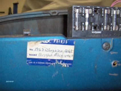

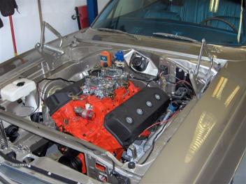

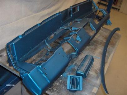

About 10 years ago I restored a 68 Hemi GTX that had the medium blue interior. On the dash I found the original paint code decal. I took a picture of it. Reading your post here, I remembered that picture and found it. Check it out.. image.jpgimage.jpgimage.jpg
