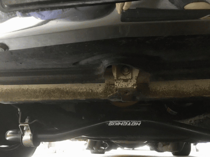

Don’t let stickers guide you. Lube well as Zerks may be gone in days. Bilsteins, Firm Feel, and USCartool made a world of difference. I like Hotchkis products but would not do again.
Handles well in the canyons for a big girl. Always warns me of immenent disaster.
