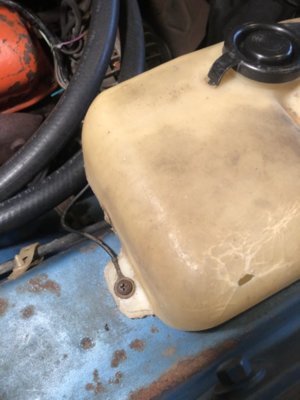

Hello everyone, I got a windshield washer pump and reservoir for my 70 gtx since it was missing and I was wondering where the factory ground for the pump was attached? Thanks.
Under the front mounting screw.
Under one of the bolts that holds the resevoir on.
The wire even has a special end to pass through the bottle and contact the fender top!
