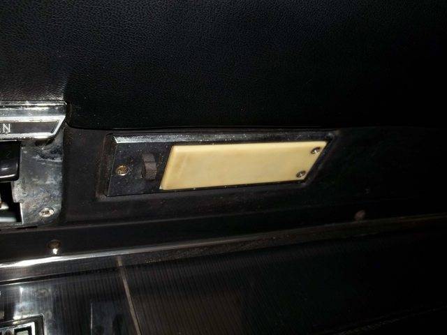

What is the trick to getting the bulb in the socket on the lite under the top over hang on the dash? There is no way I can hold it and turn it at the same time. Is there another bulb that will work in it? This is the biggest thing I need to get done on my interior. Any advice are tricks will help. Thanks Ronnie

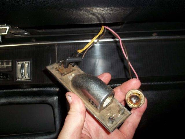

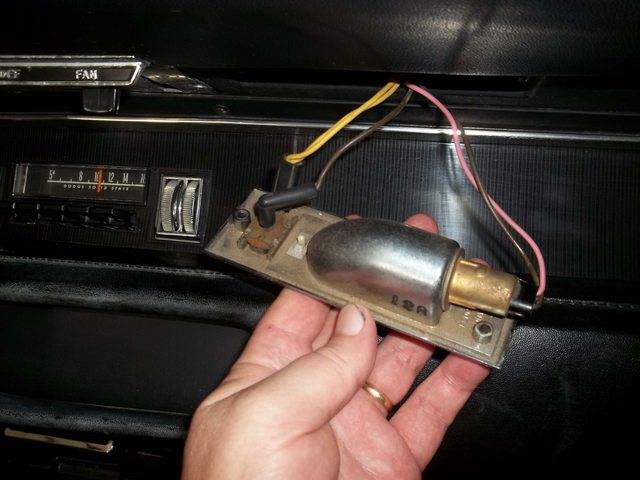

The bulb socket is connected to the housing from the outside and pops out from the end of the housing after you remove it from the dash.
Pulled out by removing the 3 phillips screws
Pull out the bulb socket from the end of the housing by grasping and pushing at a slight angle (this should be easy as it's spring loaded) and change the bulb then reverse
I hope I answered the question you are asking. If not I don't know what you are asking mate.
Unless you only have one hand .. then I'd suggest getting a friend to help.

I took it out again and yeah it's a 90 like the mechanic says .. and I lost my damned memory chip
where and how I cannot tell ya .. and I've been searching for it all night since
