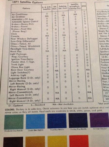

If my downloaded copy of brochure is correct, it appears that the conventional mirror was not available for rr and GTX.

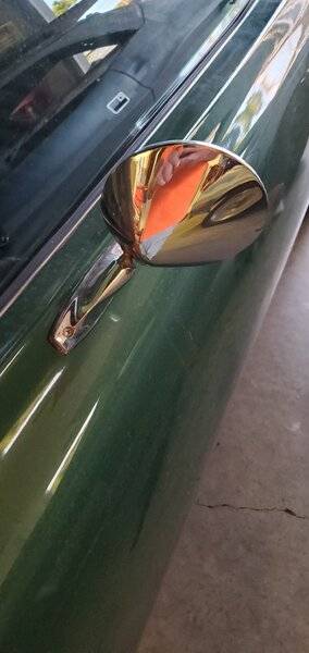

Show us the front side of your drivers side mirror so we can see what you have. Does it look like this? If so they are repopped and sold by most suppliers that sells Mopar Parts.
It doesn't exist manual round mirrors for passenger side for our 71 and lates B bodies. 65-70 B bodies and all A bodies accepts the driver side mirror to be "fitted" like a passenger side mirror due its nature being installed on an horizontal surface like all those models get, but 71 and lates B ( same as E bodies ) where the door is slopped not.
SO... the only option you get to be able to have a passenger side mirror on your 71 RR is get the Racing unit for both sides. Which btw is remote controled for driver side ( thats easy, door panel is precut to fit the joystick ).
Or get an aftermarket piece, which in any case will need to change also the driver side to match both sides. If you care

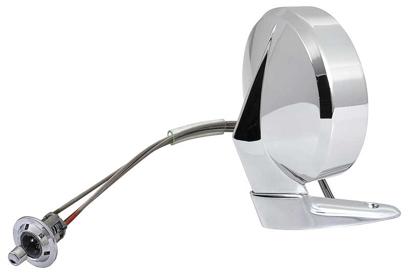

which would be this one initially used on C bodies... emulating the remote one used on earliers B bodies but pedestal shape matched to the slopped door change made since 71 on B bodies
passenger side
https://www.ebay.com/itm/1851910891...55-0&campid=5338722076&customid=&toolid=10050
being matched with remote driver side
https://www.ebay.com/itm/3249365607...55-0&campid=5338722076&customid=&toolid=10050
since 75, thicker pedestal and 3 attaching points with a stronger underside bracket. A change made on all Mirror options since that year

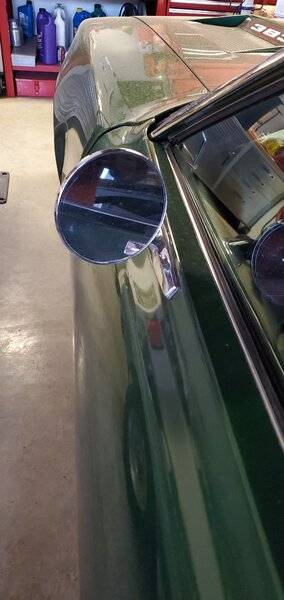

Thought I would update this thread. So the driver side round mirror can not be mounted on the passenger side, but was worth a shot. So since I wanted a passenger side mirror, and had already bought a manual RH racing mirror. I decided just to upgrade the LH side to a a racing style as well.
During the search for a repo round style. I found PG classics sells a manual LH side racing mirror, so I bought it so I won't have to punch the hole in my door panel for the remote. Thanks for everyone's help.
