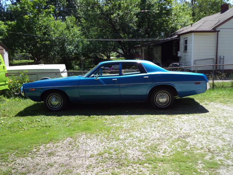

I'm doing the same to my 72 Coronet! I picked up some buckets and rear seat from a 73 Charger for mine. Nobody makes upholstry kits for the 4 door cars but they do for the 2 door cars like the Charger. You can use a 2 door rear seat in a 4 door, just the front edges of the bottom part will be squared and not rounded like the 4 door seat. What part of Ohio are you in? Would love to see some pics of your 72. Here's mine: DSC00011.jpg
