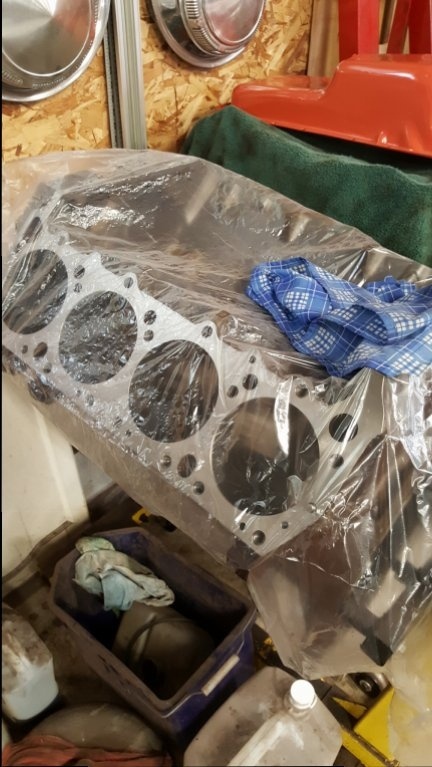

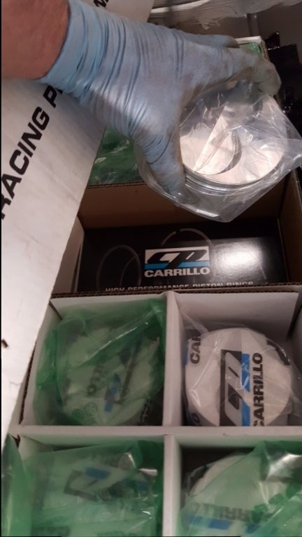

My 73 413 had ly rods, forged crank and thick cylinder walls. I had it machined to 4.25" with lots to spare. Custom pistons are pricey though!
