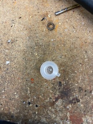

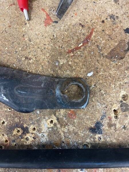

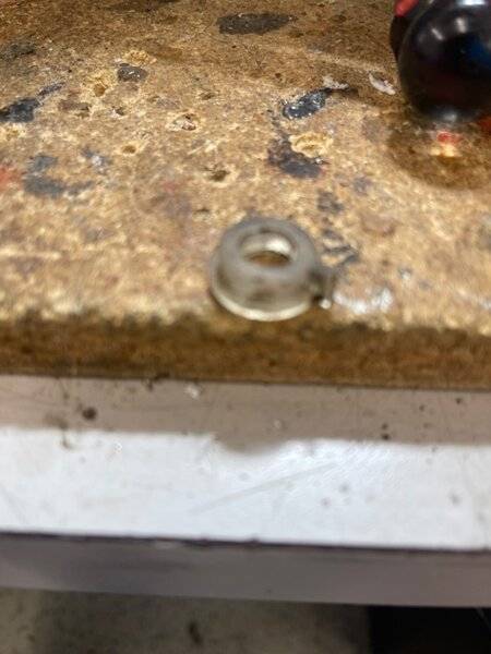

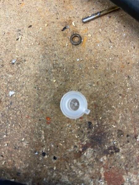

OK, so I used a bit of ingenuity and used some plastic wiper bushings from a Dorman wiper bushing kit I found at AutoZone. There are three bushings that needed replacing (actually there were no bushings left) so I had to buy two kits as there are only two of them that fit correctly in each kit. I had to very carefully grind the bushings down so that when assembled, there was enough room on the posts to use a circlip to hold everything in place. The bushings actually snap into place so they fit great once they are modified. The whole assembly is much quieter now and the wipers actually are hidden now when parked. Took some pictures, hope this helps someone who needs to replace theirs.
You have a mis-match of parts there, the link hole pictured takes the later snap-in bushings, no clips or washers were used with those originally.
