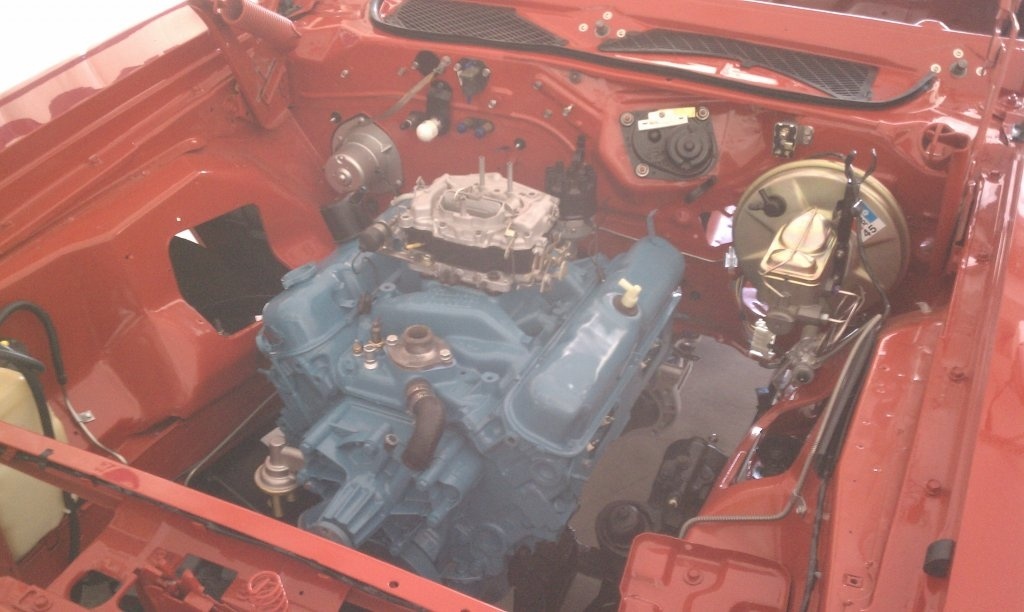

The bolts for the battery tray are similar to the fender bolts, mine have a larger washer for what ever reason. Regarding the plastic channel, yes, the headlight harness and the AC switch harness for the drier go through it as well as the positive battery cable. My brake line runs underneath that channel, and once you put the washer bottle in place its mostly hidden under it. Here is a picture when I was building that shows the channel and one of the battery tray bolts.
Regarding those 1/4 20 speed nuts, there are two smaller bolts are for the brake line brackets for the line that goes to the drives side front line, and there is one that is for the headlight harness ground, but that is threaded bolt similar to the fender bolts. Without seeing what they look like I can only guess.
