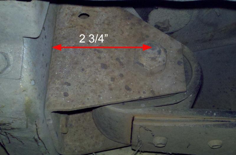

just for the sake of comparison, because this has peaked my interest, my 48,000 original mile 74 charger SE has the original springs, and they have the round spring eyes. from the back of the perch to the center of the bolt is exactly 2 1/8" . I would like to know what the measurement of the elongated spring eye perch is , if anyone knows.
I posted the previous image of the oval spring eye from my 74 Road Runner. From the mounting surface for the front perch to the center of the spring eye bolt measures 2 3/4 inches. See attached pic.
