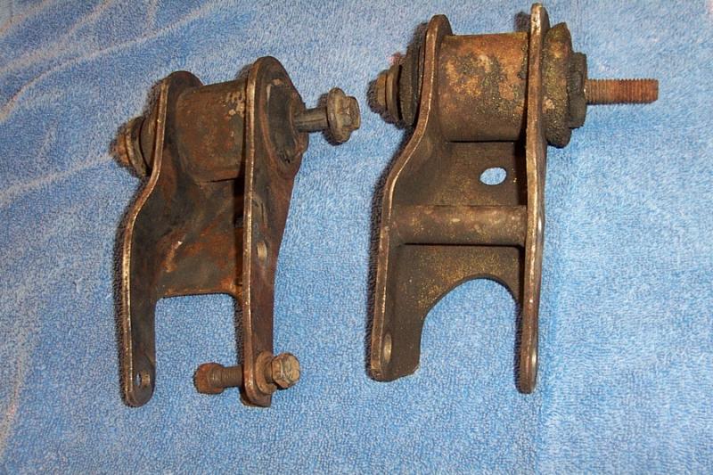

Okay, I'm confused. I need a set of motor mounts to install a 440 into a 74 Roadrunner, and I'm seeing a whole lot of conflicting information. Can anyone tell me what the correct mounts are? Links to ebay items would be super. :)

Here is what they look like.

Great! So what are the other parts that look like boxes with a bolt coming out the front and back?
Aren't those spool type mounts. I think they need a spool K member.
73 - 79 are spool type mounts for all bodies for 73 - 79 k members
The pic I posted are the spool type. 73-up A and B
The box looking ones with studs are the biscuit type. 72-older A, B and all E's.
