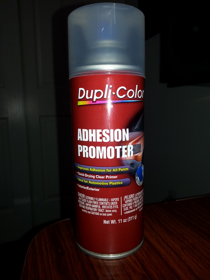

I too want to paint the interior pieces of my car. I am changing from blue to black. What kind of adhesion promoter are you referring to? I don't want this to peel off in 6 months. And will it stick to pieces other than plastic? Suggestions?
Thanks
I have used Dupli-Color Adhesion promoter on my fan shroud, splash guards, bumperetts, etc with good results. Just make sure you clean and degrease and lightly scuff the parts before using. You have to do 2 to 3 light coats, and have your color ready to spray within 10 minutes of the last coat of promoter.
If you are doing metal parts, then follow the typical methods for painting metal, clean and use a good primer for metal(if its bare) before spraying color.
Here is what I used.
