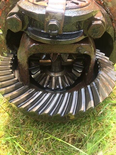

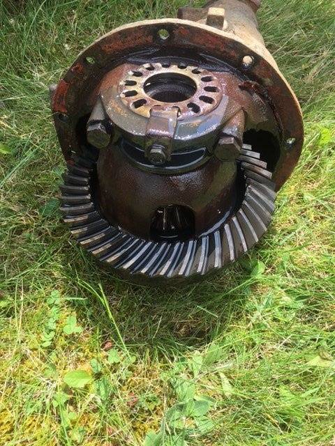

43 teeth
Here's a couple pics
Marked one of the teeth and turned yoke almost 4 times to be back to mark..
Forgot to add 11 teeth on pinion
So if my calculations are correct, we're looking at 3.91 gears.
Unfortunately all that for gears you're not interested in! Sorry, We tried!
3.90909090909 :D
