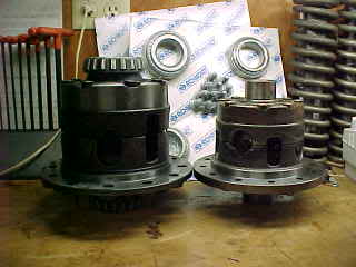

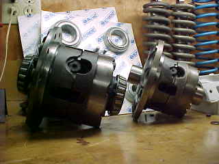

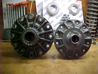

Yes, the 70 is bigger but uses the same rear cover. As for the truck 60....they do not have the machined area for a snubber. They also (most) have full floating axles but the newer ones that did not have limited slip units were semi floating most of the time. I'm not up on the ones after the late 90's. And some food for thought.....a SureGrip for a 60 vs an 8 3/4.
I have been setting up differentials for 30 years & built a 83/4 for my STREET strip 68 Charger,512,very mild set up, it was a handfull with street 295/50/15 tires, 60,70,mph it would BLOW the tires off, put some Drag radials on it& broke the 83/4, I wasted over 900.00 in parts, I knew better than go 83/4 but money was,is tight, called Dr diff & got me a S60, :)
