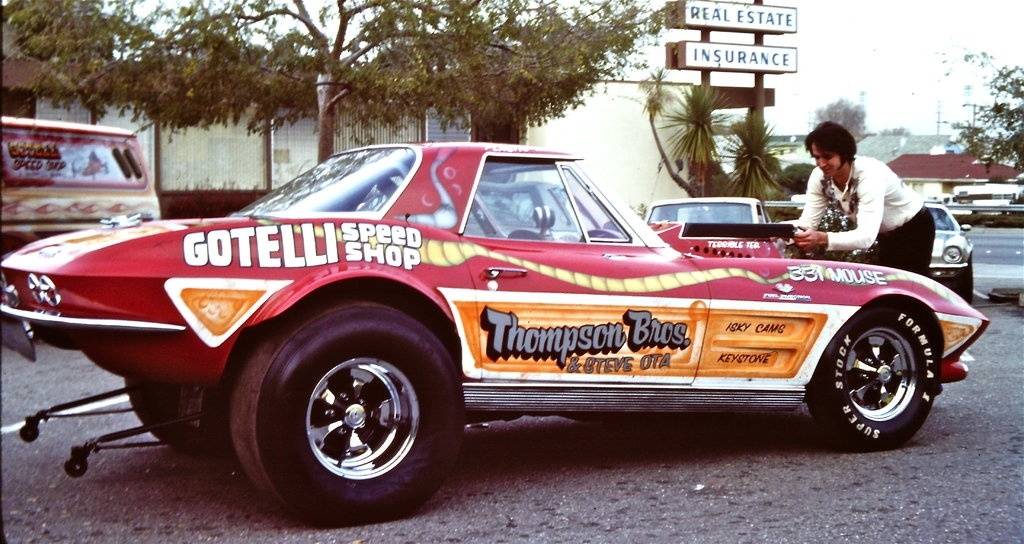

I believe the Corvette weighed in right at 3,000 lbs. without driver. It had a 331" small block, 12.5:1 compression, severely ported 2.02 heads, Isky roller cam, Isky rockers and a tunnel ram with 660 Holleys. I launched it at 6500 and shifted at 9,600. It had a rock crusher 4 speed with Joe Liberty gears and 5:38s in the rear, which was supported by lift bars and the transverse spring. All that is so dated now...lol. It ran very low 10s, which, for the time was competitive. Now you can buy several cars off the show room floor and beat that by train lengths...
