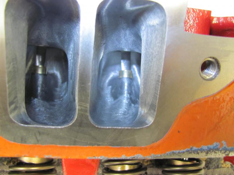

The 906 intake port. Sometimes you make something pretty and nobody ever calls you back to say how it runs. I think these were supposed to go on a '70 Road Runner. The 906 up against the best OOTB RPM I ever tested. The RPM flows are from 5 or 6 years ago and flowed very near their advertised specs. The later ones I've tested have dropped off some.
Lift.................OOTB RPM IN/EX..............Ported 906 IN/EX
.100......................73/70..............................80/61
.200....................148/126...........................161/126
.300....................209/160...........................219/175
.400....................254/188...........................262/201
.500....................276/206...........................280/215
.600....................287/217...........................297/221
.700....................291/223...........................297/224
Those are some "perty 906 ports" IQ52

Nice work IQ52!
