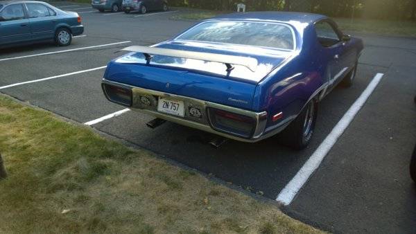

I'll dump a bunch of pics now and maybe a video since I replaced my mufflers.

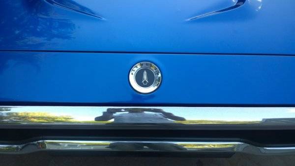

I know that's not the right badge for the car but I don't care because I love how it looks. Carlisle also brought new tail light lenses and a header panel emblem that I painted to look new.

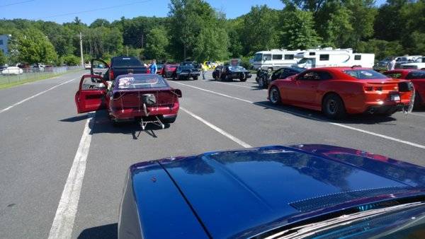

I went drag racing too. That was a blast, few hour drive to the track, made 8 passes I think and then drove back home. I have the slips somewhere at home. I don't think I was too happy with my result but still a fun experience.

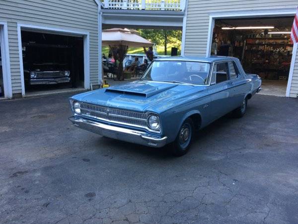

Then I went to college. On one of my breaks I replaced my mufflers I think with flowmasters but I can't remember right now. Also went to a bunch of car shows over the summer after freshman year. Below are some pics of the 65 Belvedere Super Stock car that Devin finished up. With cut outs open that thing is LOUD.
All of this stuff is a bit out of order but here are the last marks I left before heading to college!
