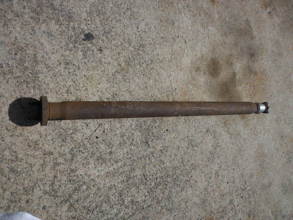

I got under there and put a tape measure on the thing this evening, checking the u-joint cap and it looks pretty close to 1.25" (!).
It has the "donut" up front like this one:
Out to out on the u-joint flange is close to 3".
Wonder what this was originally out of?
Thanks to everyone who helped. One step closer to the goal here now! :)
Ed did I miss something, all I saw was a drive shaft on the floor?
Depends on what you were looking for. :)
The driveshaft shows the "inertia ring" that mine has as well.
As I've asked here (and on another thread), is it supposed to be in this car?
Is it a good thing to have?
Ed maybe I missed something on other thread? I don't know when for sure they stopped inertia rings. My 66 has one and I have a 68 driveshaft with out one. Waiting to see how bushing replacement goes.

It's funny you say that - there's a slight possibility this one may have come from a '65. Several other (wrong) parts I've since replaced on the car have so far, I've discovered.
UPDATE 7/31/17: As noted on other threads, it turns out the inertia type driveshaft is indeed correct for my '68 GTX. The tailshaft bushing replacement on my 4 speed went great, thanks to BeeKeepers' help!
The GTX is now perfectly driveable. :)
