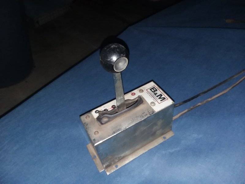

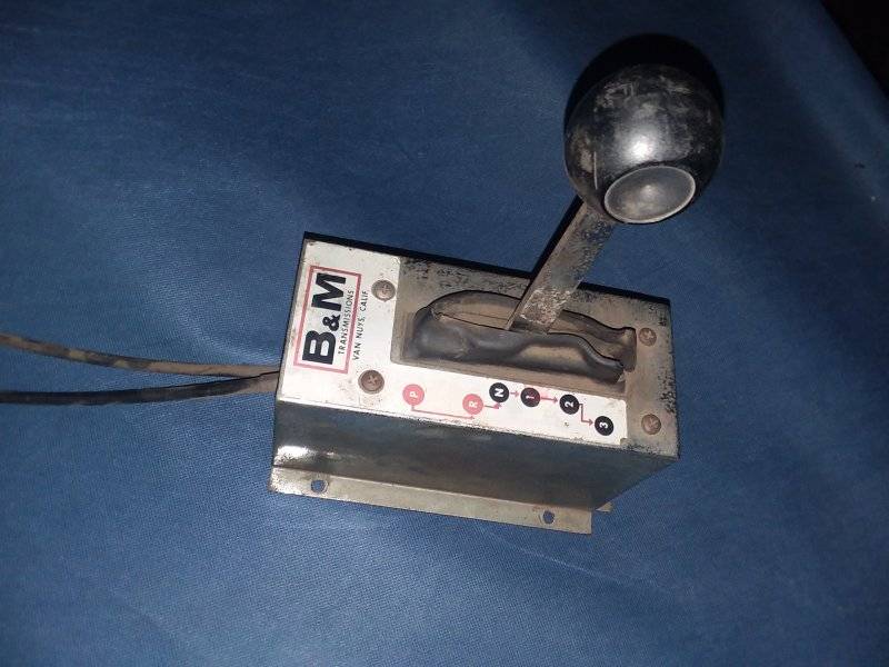

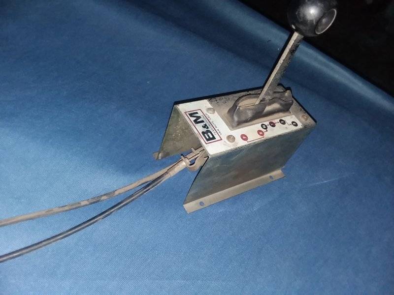

I took this one out of my Charger for a console. It’s a 80’s-90’s B&M Megashifter. I don’t have a decent pic of it in the car
I prefer the gate style shifters. For me the ratchet style were not good. I never knew what gear I was in, especially with a reverse manual valve body. Just MHO.
