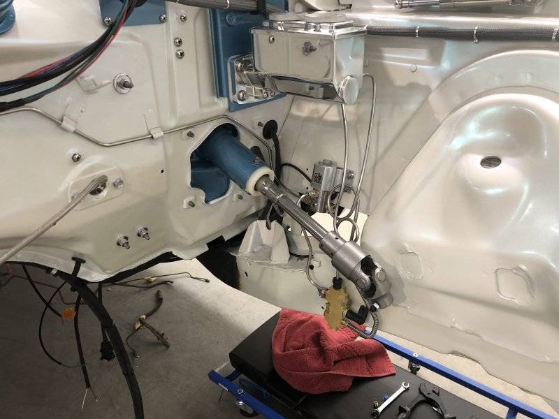

If you're wanting to do easy burnouts without hurting the rear brakes, preventing a pressure build up when depressing the brake pedal is the best way to do that.
I'm not sure what you have for a line loc BUT my Hurst lne loc is a one-way valve only. In other words it only stops the flow one way when energized. So ... if I engage the brakes first then the line loc, it will hold pressure to the brakes. However, if I engage the line loc first, it will still allow flow to the brakes but hold that pressure till its disengaged.
That said, you could not install this in the rear line with the intention of engaging it to prevent flow to the rear brakes.
