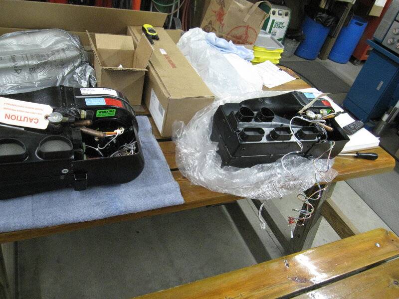

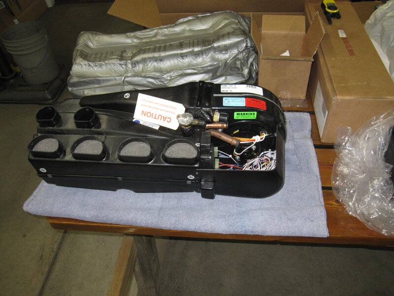

I can make you a good deal on a Vintage Air evaporator assembly if you decide to build a custom package ( VA can set you up with that option). I had to purchase a smaller model to fit my space. First photo is unit for sale, second is smaller model.

Well, thats what I saw that looked good, the controls to/for the evaporator are all electric, no cables. My cables and manual control dash unit are pretty much shot. I need to call VA and just see what a "custom pieced together parts kit" ACTUALLY consists of. If 493 Mikes unit will bolt in and I can get the compressor bolted on the 440 with not too excessive effort, the condenser and custom lines should be not much problem. thanks all....
