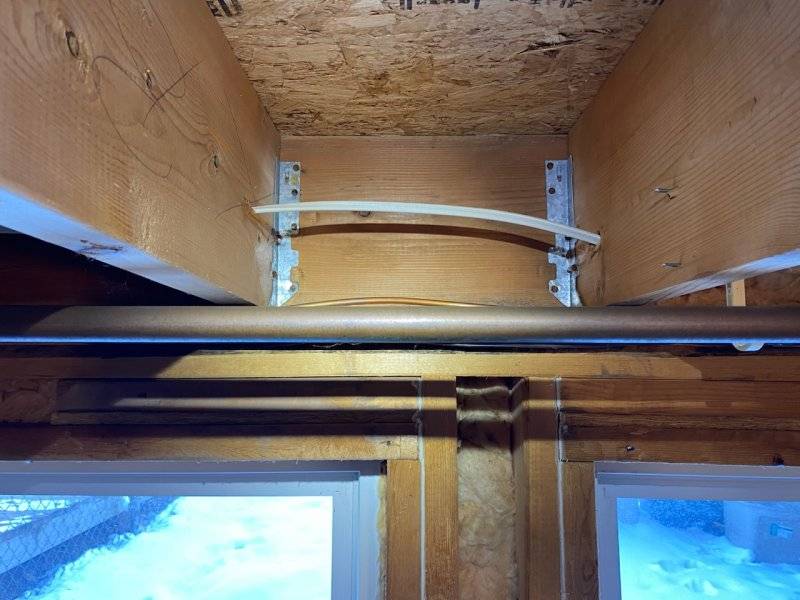

Have some questions on my large exposed windows in my basement , and the construction and framing around these windows
House was built in the Year 2000 , New construction when I bought - Two story home - Basement framing and windows where part of the new construction in 2000
I am not a builder - Just trying to figure out the Sagging above the vinyl windows after I ripped off the cheap paneling
Want to use cedar tongue and grooving or car siding in the section around the windows but don’t like what I see with the framing around the windows

Sounds like it was poorly framed
Pictures would help.
Agreed, could be framed wrong and the load is pushing down the header or something.. The "Illegals" do most of the framing down in Delaware near my Parents and it's horrible I don't even know how it passes code with what I seen on $650,000-700,000 homes.
Is there a header above the windows, or is the foundation sill plate all that's there ? You may be carrying the wall framing above, and definitely need a header for correct span. Get some pics up when you can...

There is an outside rim board or header , that extends the full length over the windows
That extends from the outer corner of the concrete foundation to the opposite side 2 X 10
The floor joists are 2 X 10
Where the floor joists go directly over the windows , they attach with joist hangars (Like you would use in deck construction) to a second rim board or header
So in theory over the exposed windows are TWO rim boards or headers with joist hangars

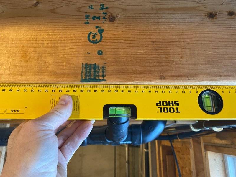

All these first floor basement joists are dead nuts 100% level - Everything looks perfect when I removed the insulation

They doubled the sill plates from the concrete wall over the windows under the floor joists , everything in the basement and first floor construction is with 2 X 6 framing
It’s the framing itself or boards at the bottom of the double sill plates and the top windows that has settled or bowed
The way they cut some of the boards and layered everything on the bottom of the windows resting on the concrete foundation and the top that I mentioned I just don’t understand the theory
Three windows - Each at 38" X 60"

Two headers or rim boards behind floor joists on the outside
Second header or rim board is above exposed windows , each floor joist has an metal hangar attached to header or rim board since new construction in 2000
It sounds like there may be a low spot in the slab. By your description I think it's framed correctly. Pictures would help diagnose the situation though.
Your description is confusing. The joist cannot be "dead level" if they are hanging off the header, but the header is sagging. I was a framer once, and then construction my whole life. I'll await the photos.

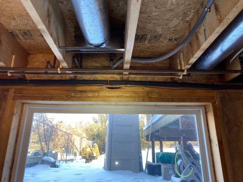

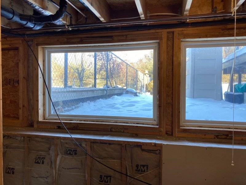

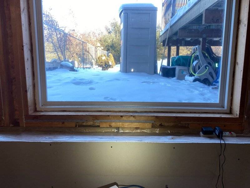

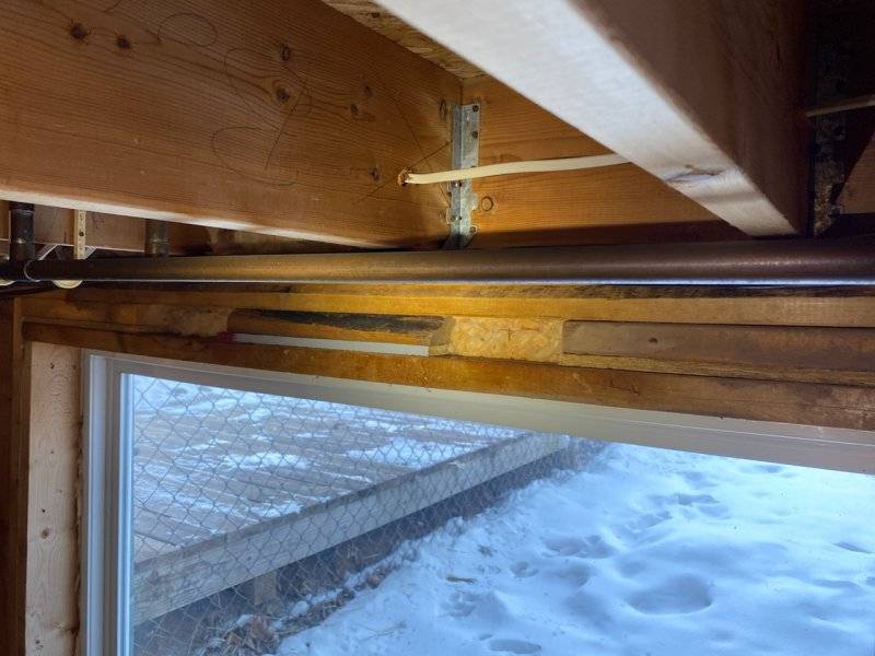

Look at the sandwich / shim job above and below the windows , once I removed the visqueen and insulation
Anyways
Looks to me that you need a proper header over those two windows. Appears that the sag in those two windows is right below the blocking they used. The blocking is carrying the weight. Needs a header
