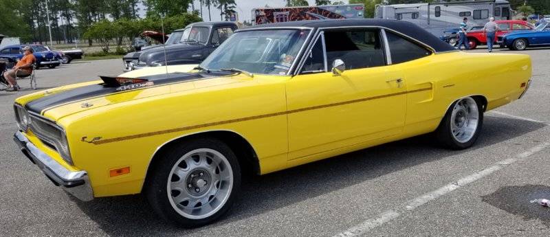

the Year One aluminum Rallye wheels pay such an exceptional homage to, and so closely appear like, the 15" steel Rallye factory wheels that I am likely to NEVER be swayed into choosing ANY other style.

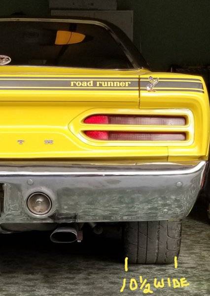

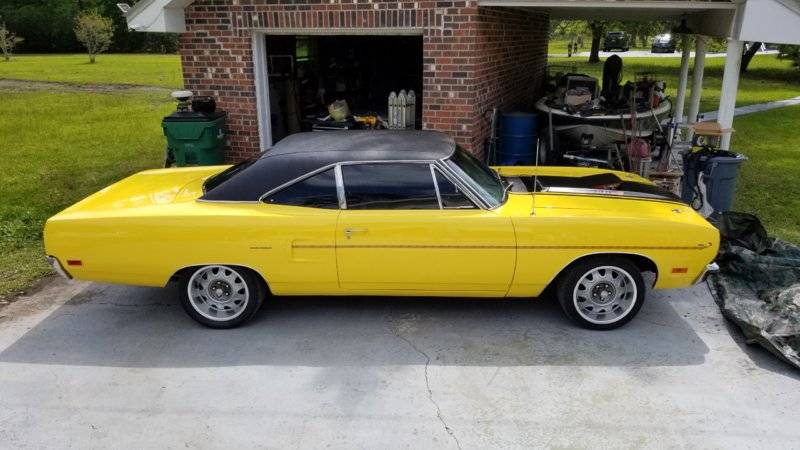

My 9" wide rear aluminum Rallye wheels with stock 5" backspace fit 315/35/17 Toyo Proxes TQ drag radials on my stock suspension, perfectly centered, never rub, look fantastic!
My question is "Is there a reputable source to send a new pair of these wheels to in order to widen them with whatever the new proper offset would be if I mini tub or tub my rear wheelwells and replace or modify my rear suspension, maybe even narrow my Dana 60 so I can accommodate MUCH wider drag radial or slicks?"
See pix. Thanks for any help!

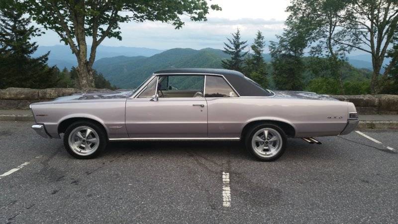

I actually need to know more urgently for my wife's GTO rear aluminum Rally II Pontiac style 9" wheels because we will be ordering a new 9" Ford based posi for her 65 GTO and that could influence the width of axle I choose. I blew up the crappy stock Pontiac 8.25 open differential and we have been needing a high performance Ford 9" replacement rear axle w/"posi" differential anyway because the BUILT 421 TriPower (bored .035 over-now 428) is a torque monster and has a field full of horses too. I don't think she would "go for" mini-tubs, so I really need as much rubber in the fenderwells as possible. Last full run in her car with the open one-legger on 275 Toyo Proxes TQ drag radials and I smoked the tire at the 1/8th mile when I put my foot to the floor at appx 60-70 mph. Her car is a 3 pedal car too.
Thanks. Here's a pic of the 8s on the front and 9s on the rear.

I just ordered the Quick Performance 9" based rear axle assembly for the GTO, and I am getting it 2" narrower than stock because I have 2" of clearance to the inside frame, but zero space to the outside inner rear fender.
On my Roadrunner, I would still like to have a new pair of those aluminum Rallye wheels widened, so I will check out the referrals.
