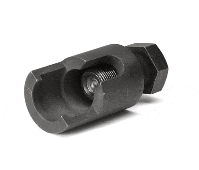

After thought: Correct me if I'm wrong but the upper screws in and the lowers are press fit or do the lowers screw in also like the top? I made my own socket for replacing the tops but I cant recall how the lowers were.
If this is a pic of the lower, they screw in.

BJ to LCA should be press fit for 74 unless someone put a 73 LCA on.
BJ to spindle should be standard 'pickle fork' cone bind. Smack the fork until it sticks, then smack the spindle.
I was wailing away with a pickle fork all day. Finally got the upper to release by hammering the fork with a 22.5 pound weight from my son's weightlifting set. :) Even that didn't phase the lower one though.
The upper is screw in... and what a pleasant fricking experience it was getting the old one screwed out. :( The lower one is pressed in.
