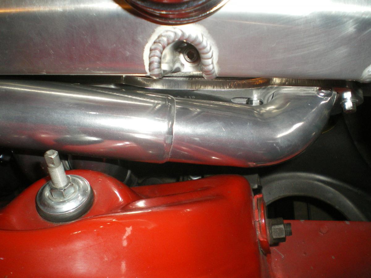

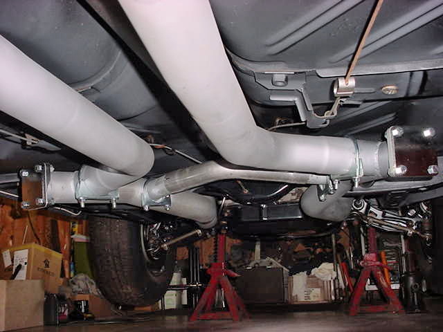

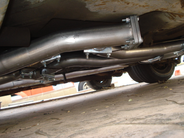

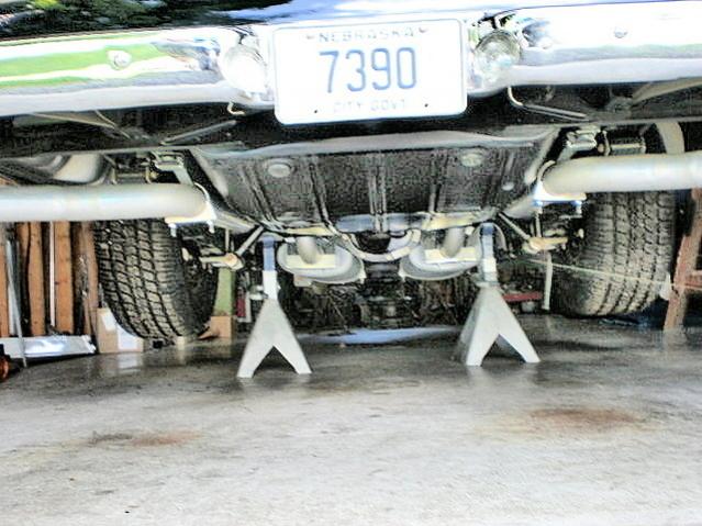

Complete 3" TTI Max Wedge on my 62,fits like a glove,no clearance issues anywhere.

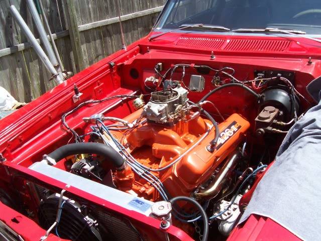

I used 2" tube TTI headers and complete TTI exhaust system on my 440 powered '62 Sport Fury. No clearance issues. Everything fit perfectly.

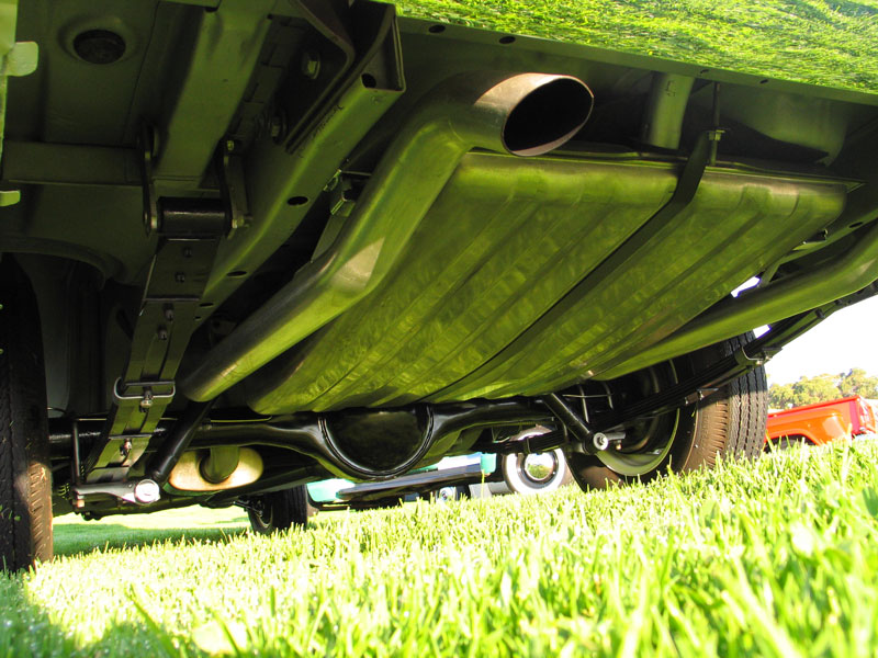

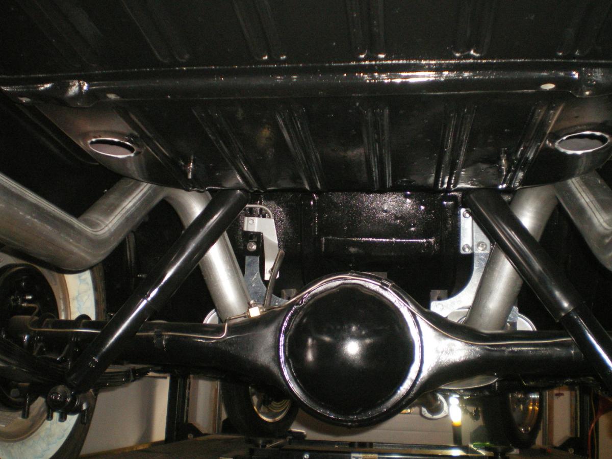

big daddy-o go with the tti system. it is awesome. heres mine in my 63 max wedge savoy.

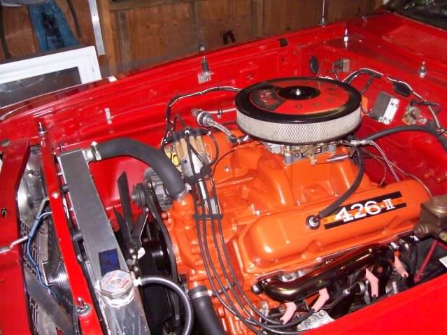

Just put the complete TTI 3" system with the TTI 2" headers on the new eng in my 63. Great system that fits great. Ron

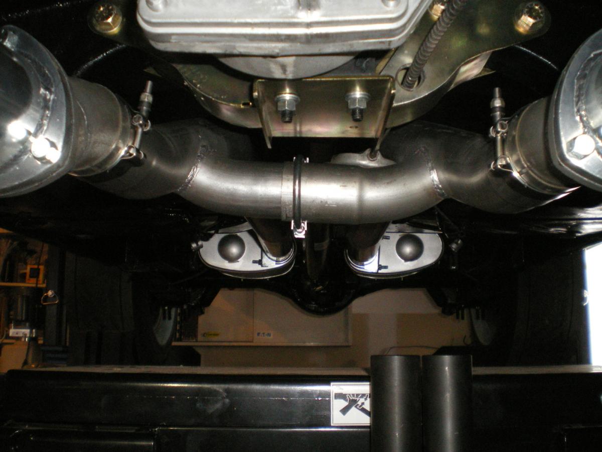

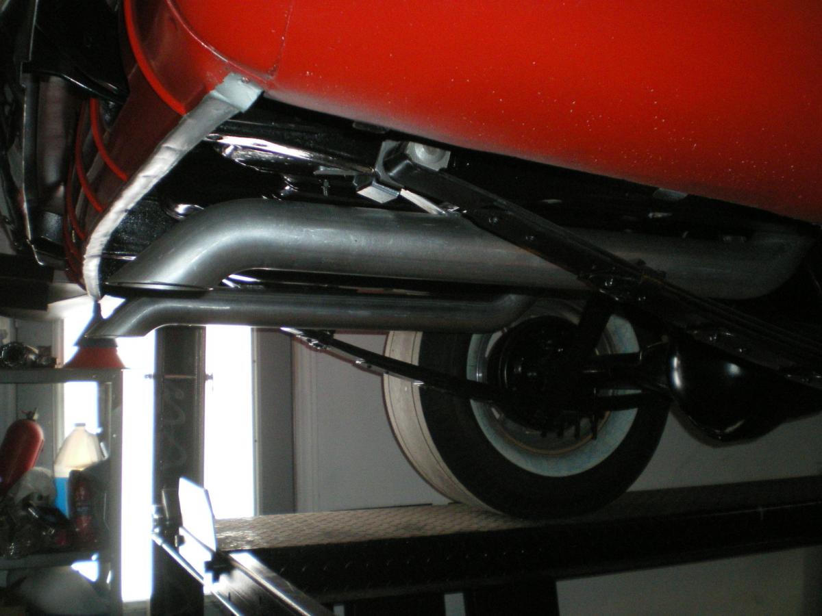

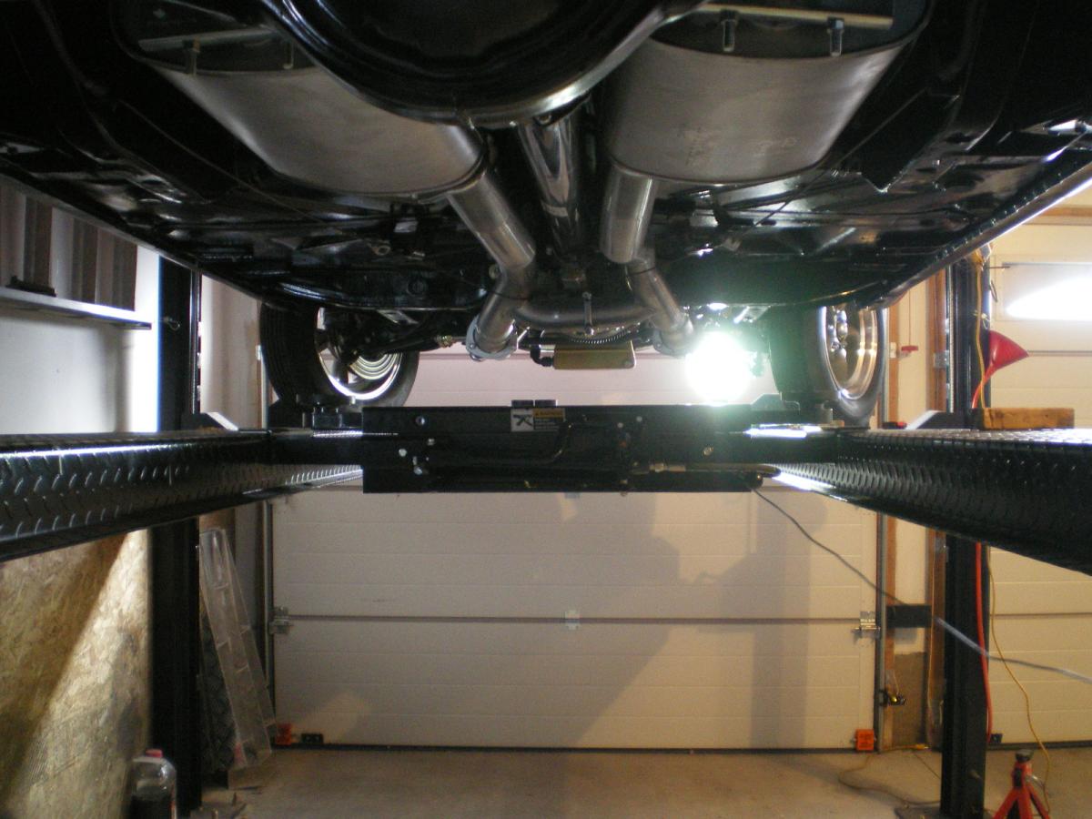

Not the best pic but I used the X-pipe 3" system with Dyno=Max Ultra-Flow mufflers. Ron

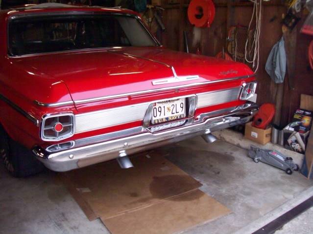

To the tailpipes. Ron
TTI 2" headers to 3" X-pipe and 3" exhaust to the bumper with Flowmaster 3" 50-Series. Absolutely no problems!

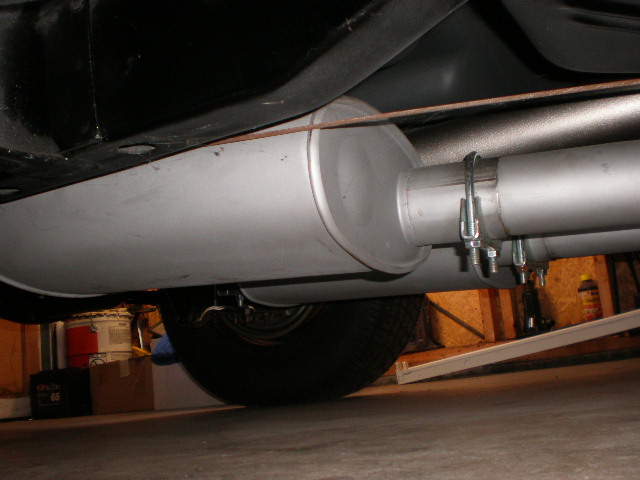

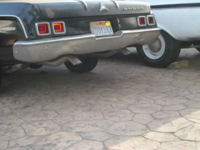

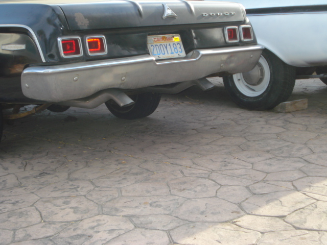

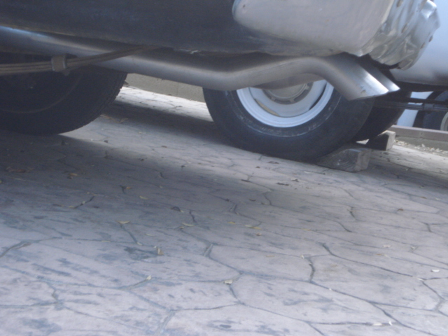

Here is a shot of the 2.5" TTI tailpipes on my 64 Dodge for comparison.

sure do like the 3" ones better!!!

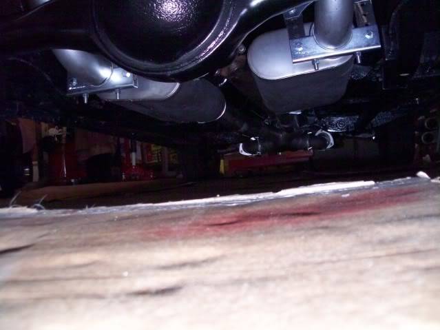

have a look!!!!

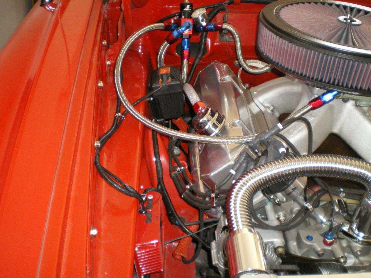

You guys have any plug change issues with these headers? Especially the larger OD ones?

with my 2 1/8 stepped headers and super victor heads the passenger side is a biotch and has to be done from the bottom!
