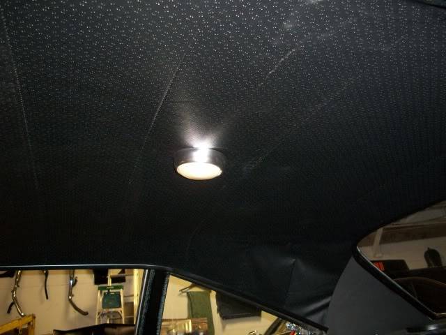

thanks for the ref pics and link Bill very good tech and very informative! Do you have any convertible top install posts or experience too? "my other car is a hardtop" :)

Looking at that dome light, I wish they made a separate switch for that thing and not the roller knob on the dash that also controls the dash lights.
Or, maybe that's just how it works on MY 69 Satty. Someone outta make a mod for that that fits on the dome itself.
You're welcome!
Sorry, no convertible top posts or experience here. Just done a few headliners and vinyl tops on hardtops is all.
