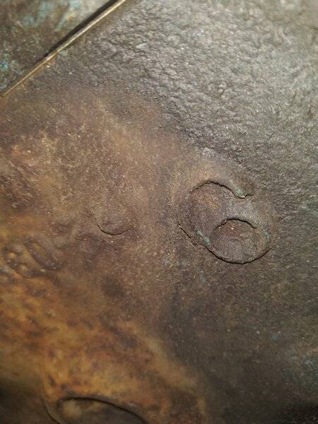

But what does the -3 stand up for?
No idea. It had valve rotators. More nickel content in block, different cam and less compression.
This was from a Mopar chat site back in 2000 so I don't know where the info came from.
The 360-3 Was a "Premium" V8. It's features included Induction-hardened crankshaft journals, tri-metal main and connecting rod bearings, hydralic valve lifters, sodium-filled exhaust valves with roto-caps, and a chrome-alloy cast-iron cylinder block. These things should be in your engine since the -3 indicates a Premium built engine. Hope this is of some help.
