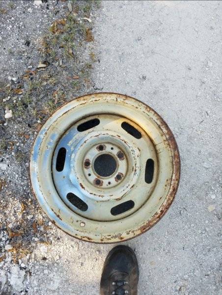

Looking to clean up and repaint my 6-hole cop wheels, but need to know what rattle can paint gives the most durable & close to factory (Black) color attainable? Eastwoods? Duplicolor? Rustoleum?

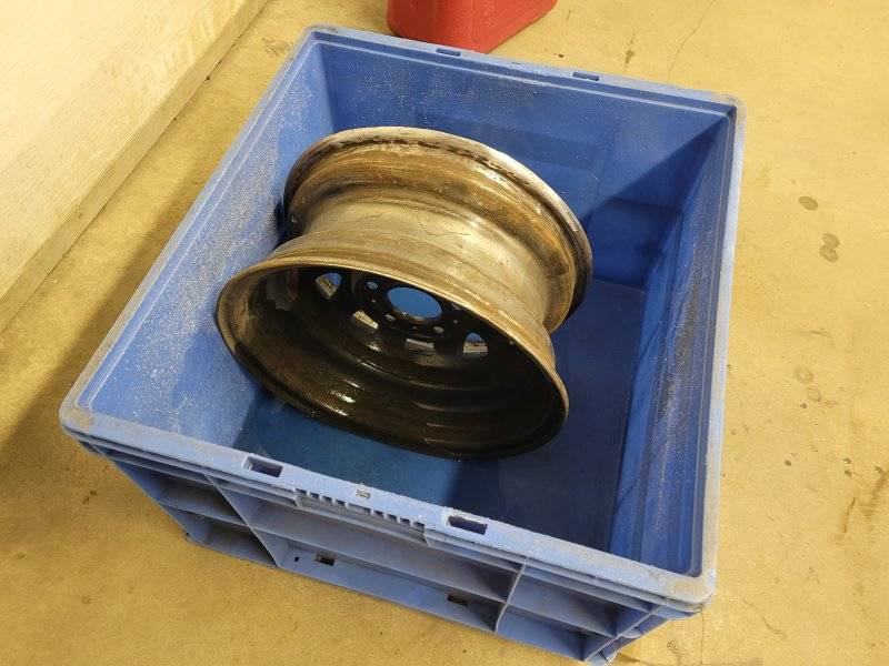

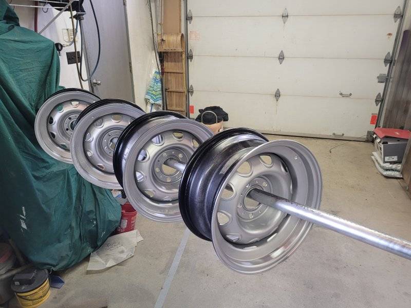

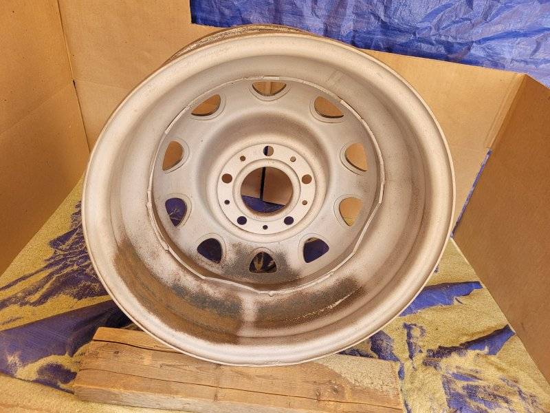

Cleaned in 100LL AV gas.. best degreaser made.
Media blasted with crushed glass..

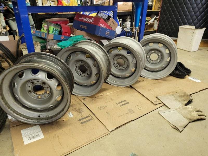

3 done, one to go..

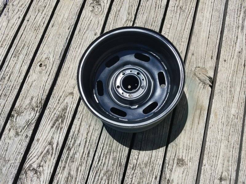

All painted up, VHT high heat wheel paint btw...

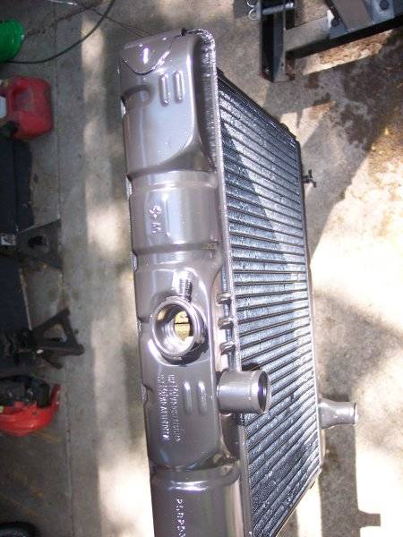

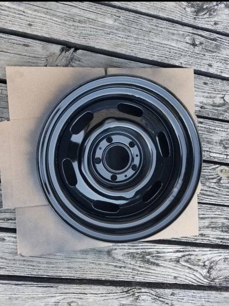

For durability, Black appliance paint. I've painted wheels even over chrome with good results, I use to use it exclusively on motorcycle frames, very chip resistant.
It will be gloss, but if you spray a second coat within 10 min, it will dull to a Satin. Paint is very forgiving, almost self leveling, but easy to over spray and cause runs, take your time. Try it on an old wheel first to get the hang of it.
I like HDepot's version over Lowes

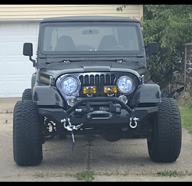

I painted the 2 front fenders on this Jeep with it.
side note, that's a 99 TJ that i grafted a CJ front clip to, prolly won't see another on a TJ.
Clever set-up! Thanks for sharing.

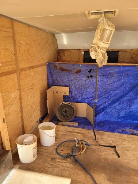

Here's the link to the full process....
