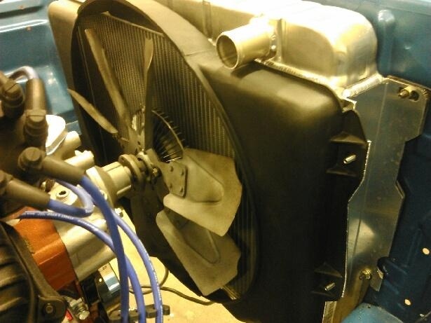

Looking to seal up all the gaps between the shroud and radiator. What did you use? Thanks.
I used a roll of foam insulation from a local home improvement store. It has adhesive on one side which makes installation easy. I didn't fully compress the foam.
I want max cooling. The AC condenser in front will slow down air flow.
