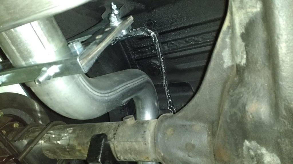

I used this. Covered all my lines from tank to the rocker in back. Then from trans crossmember to fuel pump. I like the Velcro for lines that are already in place. IMG_20170527_142441457.jpg
