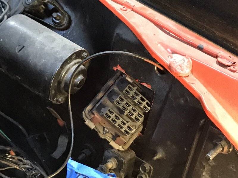

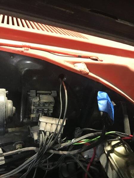

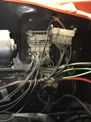

Figured I’d post a couple of pictures of the bulkhead connector removal and what I found.
Was having an intermittent starting issue.
Noticed a poor splice at the bulkhead connector at the blue ignition wire, so I removed the male side connectors and then the female base off of the firewall and pulled everything back out towards the engine compartment to examine. Easier than working under the dash!
Blue wire was toasted. I think I found my problem
That seems made by a short into the RUN ( Ign1 ) circuit. I would check the engine harness too same as the wiring down the tape from there up to ign switch.
Looooooong time ago I got broken the alternator brush ( on dual field ) grounding the RUN circuit and the blue wire cover got melt up to the cluster ( RUN circuit feeds the brake, oil light and voltage limiter on 3rd gen Chargers with standard cluster ). I didn't have fuse link on those days, just a regular jumper wire.

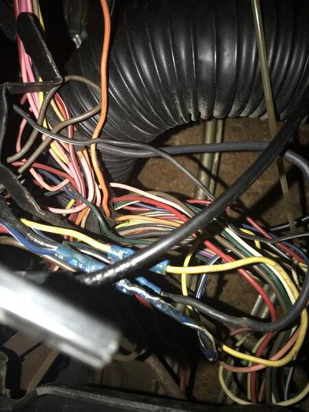

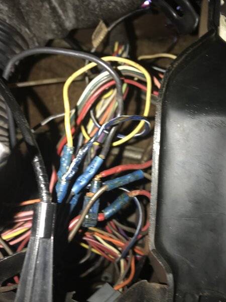

So I got under the dash to investigate and of course lots of electrical tape and this........notice bare spots on blue wire all the way to ignition switch
Time to investigate new wiring harnesses
