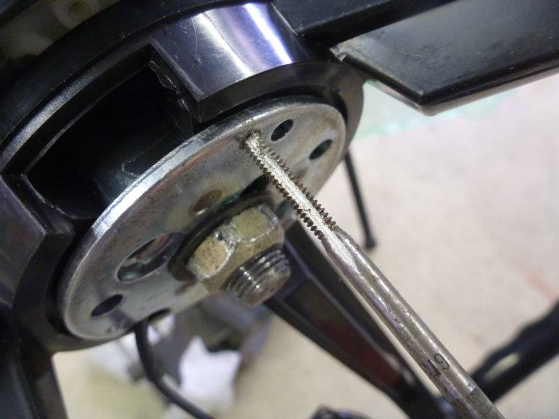

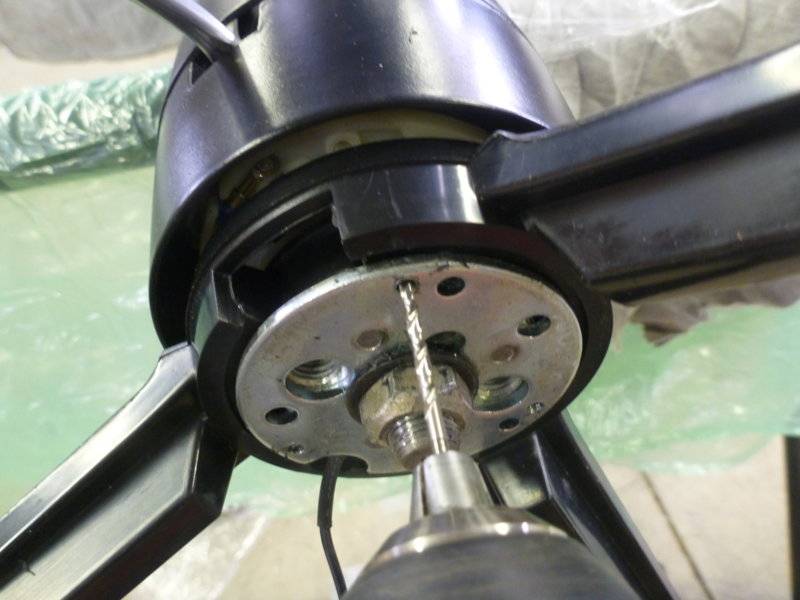

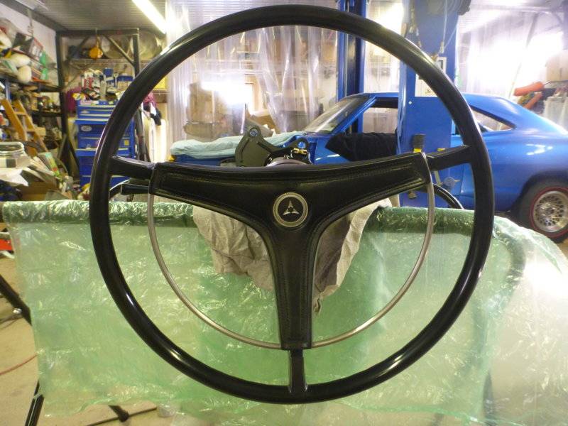

I bought a '69 black plastic wheel from PG for my Bee (and a '70 for my Bird -still in box). Smooth and identical to my OE I that removed. Only thing I had to do was tap a screw hole that was too tight and hollow out behind said hole for screw clearance. Splines went onto shaft smoothly.
