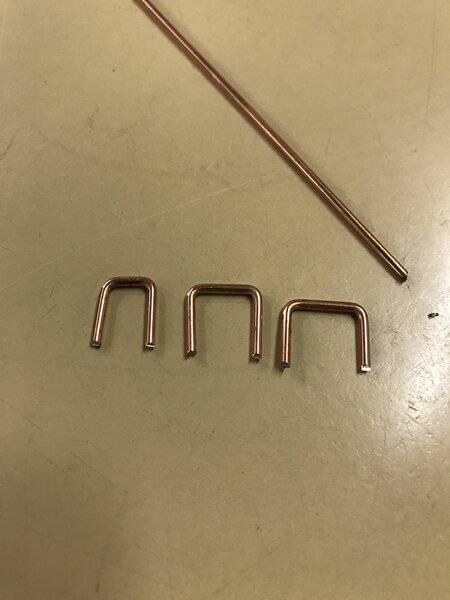

I've made them using 1/16" welding rod for many years. Find a pair of pliers the right width and start bending. I use needle nose to give me the option of different sizes. UN-coated rod will age like the original.
