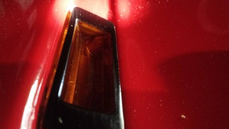

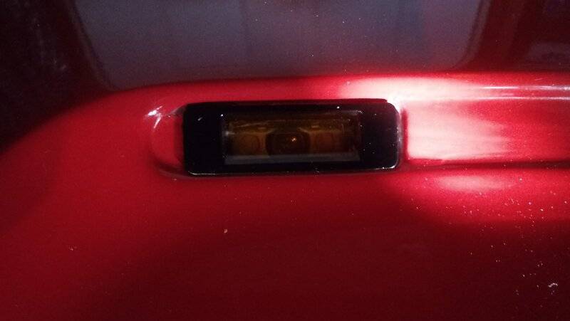

Getting ready to install my hood mounted turn signals on the 69 Charger. They look like they can be mounted either way. The lens is marked front which I find comical. You would think it would say up or down to indicate which way they should be mounted. FSM makes no reference. Any ideas?
I can take some tomorrow. I just figured someone may of had experience installing them.
I would imagine if there is any printing on the lens it should be up^^^^^^^^
I had the same issue on my 68 so I installed mine so that the longer end was on the bottom shown in the side picture.
I will know more tomorrow. I did not measure mine but is seemed even all the way around. That's why I questioned it.
Then in that case just install with the words front right reading.
I just put them with front on the top. Looking at the dirt line on my old ones that is the way they must of been.
