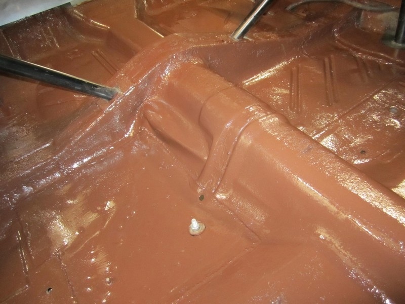

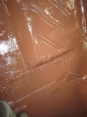

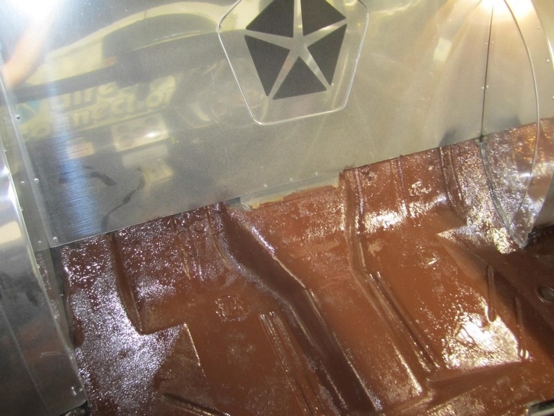

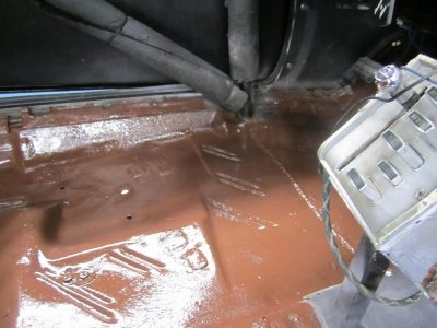

I just used rustolium,my floors are far from perfect with some hack patches done through the years.
5.19.12 007.jpg 5.19.12 008.jpg 5.19.12 009.jpg 5.19.12 010.jpg 5.19.12 041.jpg
