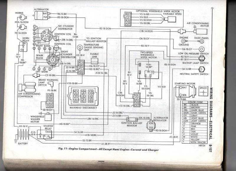

In looking at the Engine Compartment Wiring Schematic and tracing any connections back to the battery it looks like socket J might be the culprit, but could some help.

More than likely the fusible link, engine side.....or dash side to the ammeter.....or the ammeter itself......
Inspect everything on socket J.........
If the gauge is the culprit......do the bypass......send the cluster out during the winter for restoration.......and do the amp to volt conversion and call it a day.....
