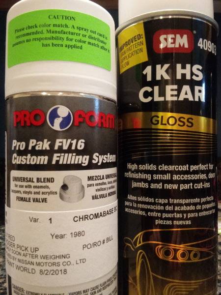

Hey guys. Need some help here. As you can see from my threads I've applied my clear coat.
As I understand it the next step is to apply compound, so I picked up some Mequiar's Ultimate Compound. According to what I've read I have to wait 3 days until I can apply it. Seeing it's going to be in the 90's all week my car will bake in my garage.
Before I compound the car can I wash it to remove the sanding dust, as long as I do not use a soap that contains any wax?
What I don't understand is that it's ok to compound but I can polish/wax the car for 90 days (per the paint shop)? Why is that? What does the polish/wax do the paint/clearcoat?
I could either do this by hand or I could use my orbital polisher/waxer, what's the best way.
Thanks in advance!

The 1k is not a chemical reaction like a 2k clear would be, like if you refinished the car. Waiting a few days may be the right call. You'll know pretty quick if it's not hardened yet.
Compound and polish are not the same as wax. As stated, the wax will not let it out gas and cure properly. Compounding and polishing are usually done same day as paint in a high volume collision shop.
Set the car in the sun, the UV will bake it quick. I don't have any experience with Meguires but you shouldn't have to use a very aggressive compound if you sanded in 2000 or higher. Wool cuts faster but with small repairs it's not going to make a big difference. Depending on how large the area is you could probably do it by hand. Use a terry material vs microfiber if you do it by hand. The terry material is more aggressive.
Just saw the spray can pics. I thought you were using a spray gun with base coat & clear coat. I don't think most of my advice would apply here. As i believe the hardeners are different.
