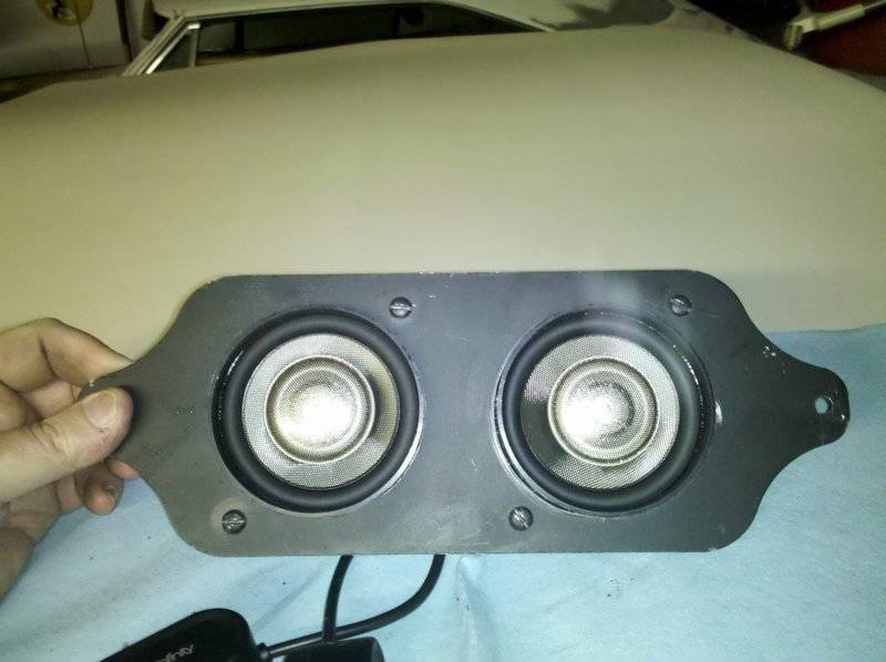

There was a guy selling a bracket that would accept two 3.5" speakers and mount where the center speaker mounts.

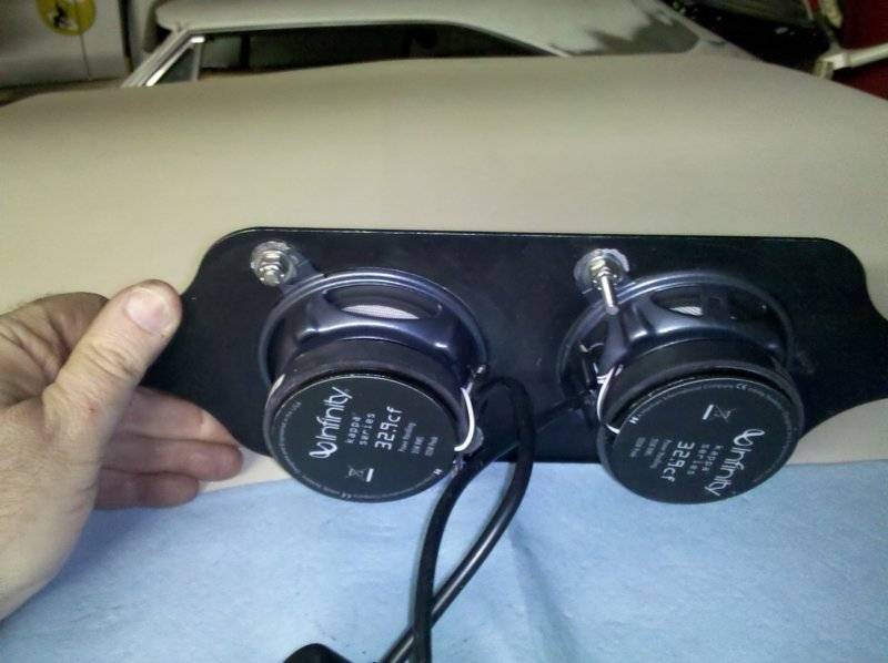

I did this on the '69 Coronet. With the stock heater controls, you need speakers that are not real deep or the temp control cable gets in the way. I used two Inifinity Kappa 3.5" speakers which are pretty deep and had that issue, but I wanted A/C and installed the Vintage Air system that uses an electronic control panel that replaces the original mechanical operated panel, so plenty of clearance for the speakers with that A/C unit.

Found some Photos.
The Bracket was from a guy on Moparts
http://board.moparts.org/ubbthreads/ubbthreads.php

The speakers I used above are 3 ways but I can't really comment on sound as I am using the stock am radio....they sound decent.

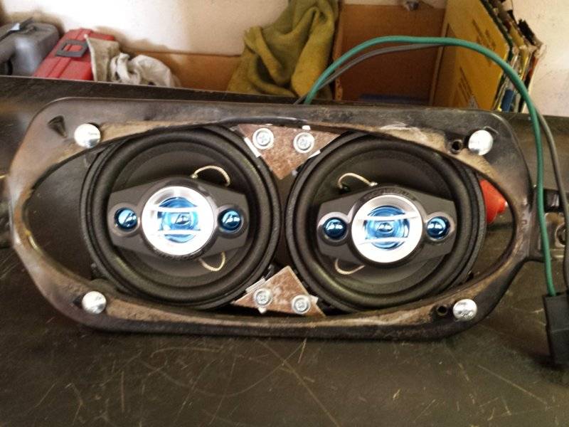

This is a 4x10 direct bolt in with "left and right" tweeters that can be connected in stereo or mono. Depending on you radio head this speaker is the right ohmage and is not a power hog.
I run this with two 6x9's outback using as Kenwood low amperage head and they (it) sound quite pleasing. For bass I have an "underseat" sub with it's own built in amp. You can go with what ever speakers you wish but make sure to match their capability with the head unit's output. On the 4x10 you do not need a crossover because the tweeters have filters already built in.
