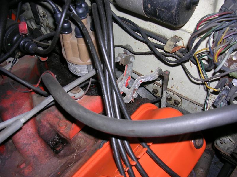

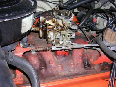

Thanks for the input! I'll post some pics of what I've got tonight. I bought the intake a couple of years ago and it came with a carb that appears to be rebuilt, or clean at least. I don't know what kind it is though, of the top of my head.

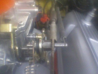

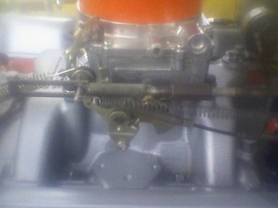

if you have the threaded type TP adjuster , you can simply extend it with a barrel nut and a short piece of all thread. this is all 2 barrel brackets and cable. sorry for the crappy pics

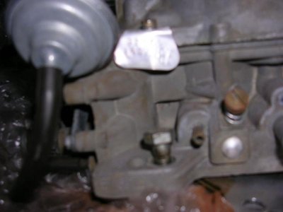

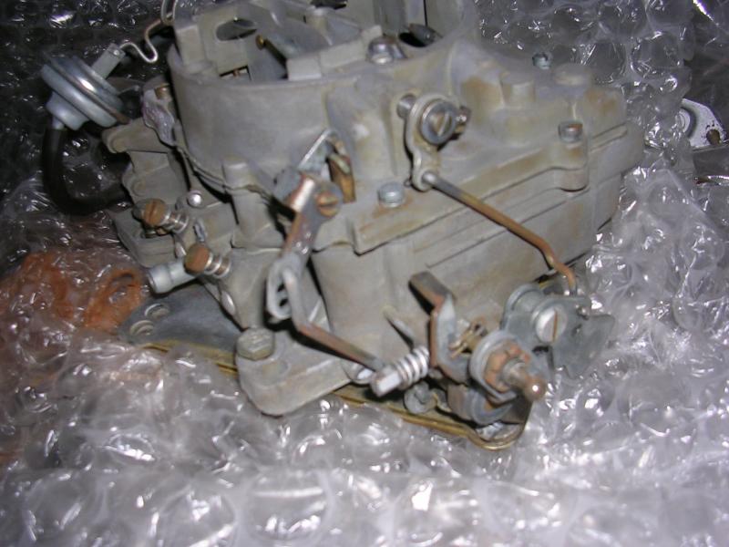

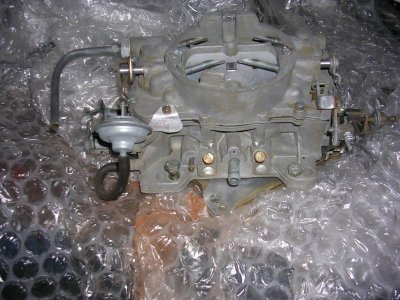

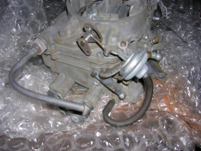

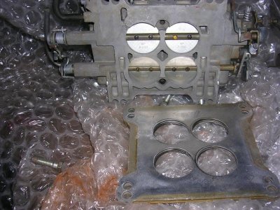

It's a Carter AFB. It has the following embossed on the base: E7 6212S. On the tag is 6212S(or 8) 1467 and 67. I'm going to try and find out what the CFM rate is for this one, if I can.

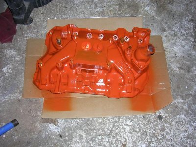

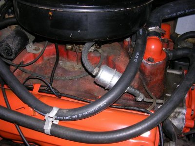

Not to critique color choice...it's your car, but you are aware the original motor color is Red, correct? For all I know you may have a color scheme already planned. If so, please ignore my **** rentive comment.
As for the linkage, looks like you will have to lengthen or swap the 'kickdown'/ throttle pressure arm. dvw mentioned he may have the correct one? Otherwise you can either cut your rod and splice (weld) in a piece of round stock, or do what super77se did and use one of those barrel nuts and a piece of threaded stock.
You may need to make adjustments to the return spring anchor bracket to get it further forward. If not, find one that sits further forward.
You also may need to fab up an 'extention' to the throttle cable mount to get it further forward (closer) to the carb. You 'can' simply clamp down on the black cable casing, but that's not what it was designed for.

Yeah, I like the orange better. I will probably change the color of the car too. Not too keen on the beige/yellow color. The carb is a marine application so I don't know if I'll use it or not, leaning towards not.

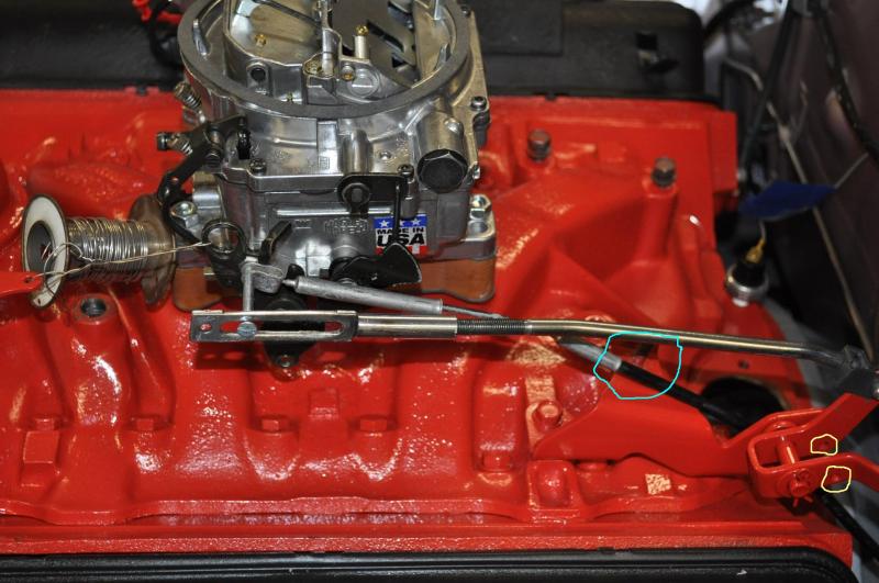

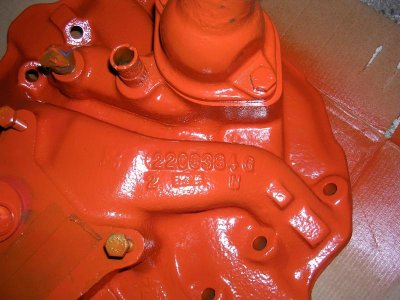

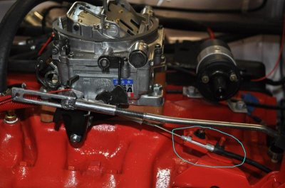

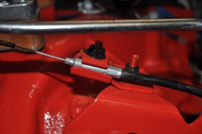

Here are a couple photos of what I was referring to earlier. The yellow circles show the holes you will insert a drill bit through to 'pin' the linkage. Don't forget the 3rd hole in the stationary bracket you must also go through or everything keeps moving! This gives you a reference point to ensure adustments are correct. Provided your car was opperating fine before, you shouldn't need to adjust the rod going down to the transmission.
The blue circle shows where the throttle cable was clamped in place. Using my sawz-all, drill, grinder and jewelers files, I made the bracket (2nd & 3rd photos) by cutting down and bending some scrap 1" angle iron I had. I put the 'step-up' in it by clamping it in the vise and 'working it' with a 2lb sledge. This got the proper angle to the input rod. You will also notice the cable is now mounted on the 'outside' of the original clamp bolt. This is done to get it inline with the (wider) 4bbl carb input.
I re-used the original throttle cable clamp, just reversed it (inside to out). To make it work in the fabbed adapter, I drilled a hole then welded in a bolt (welding not req'd), then marked where the alignment tab goes on the opposite side, drilled multiple holes in line, then filed the opening rectangular with jewelers files. Took an evening, but it looks like it could have come on the car. Hope this helps.
