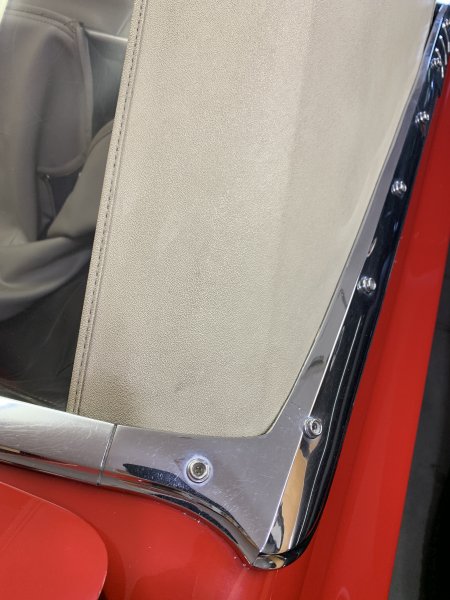

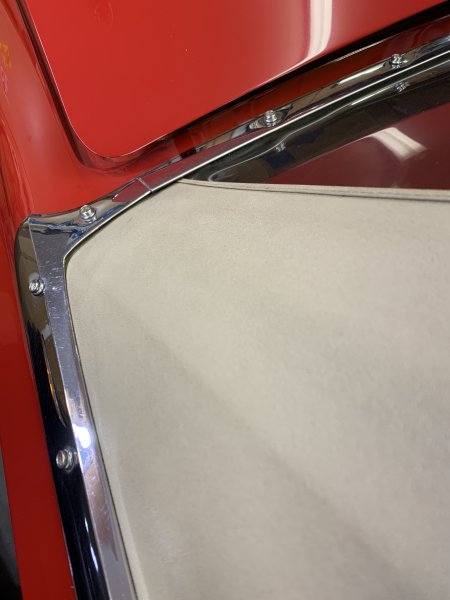

I’m picking up my car after getting a new convertible top installed. I see big gaps in the corners. Is this normal? If not, how do I fix this?

Thank you. I left my car at the convertible top shop because of this. I appreciate your help! Also, if you don’t mind, please take a peek to see if there is some type of foam or something between the rear window “curtain” and the top itself in the corners holding the corner of the top up & flush with the body. I “think” mine had that at one time????
Sure doesn't look right to me. Don't know your car. This my 63 Fury...

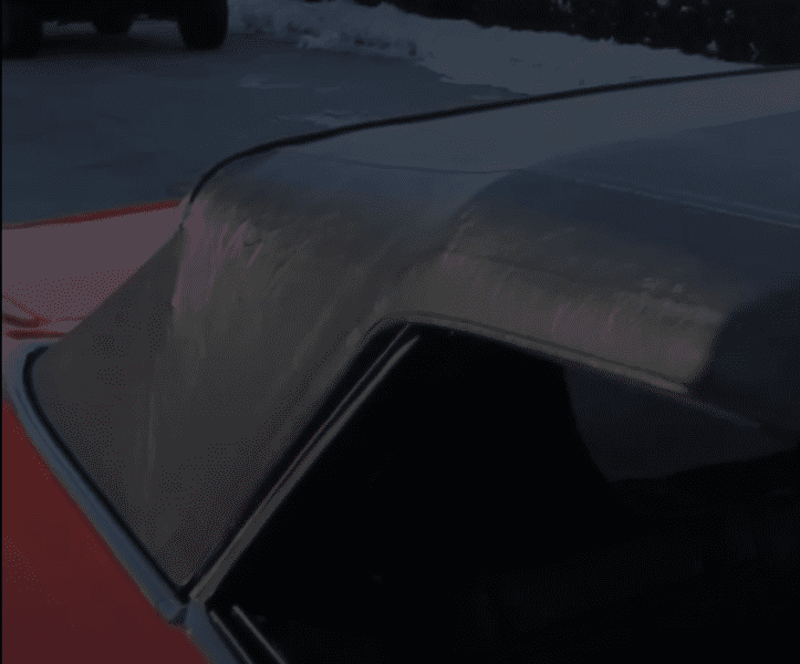

Pretty detailed video here.. Music to sooth you. Also has massive gaps too.
This video had a 68 RR and the gaps are way better. But still don't look tight.

Thanks! Dang, that gap looks like water would flood in there more than the drip tray could handle. That is similar to my problem, but the red car isn’t as bad

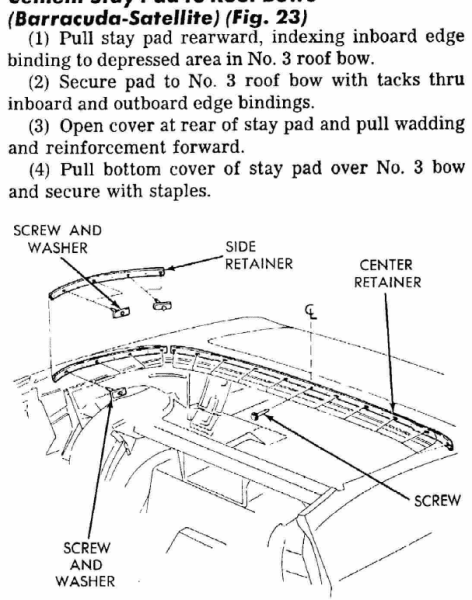

Also found this in the shop manual. Make sure they have the side retainers installed. Thats what I think seals the top to the rear and side. If you have the shop manual section 23-157
If you need a downloadable shop manual here is the link. https://www.mymopar.com/downloads/servicemanuals/1970_Plymouth_Service_Manual.zip
Thanks! Yes, the side rails are installed. It “looks” like you’d need to raise the back part (only) of the side retainer rails to seal the corners. The shop owner talked about some side rails having an “upward extension piece” on the back end to take care of this (non-Mopar). I’ve also wondered if they got the side retainer rails on backwards (left/right)?

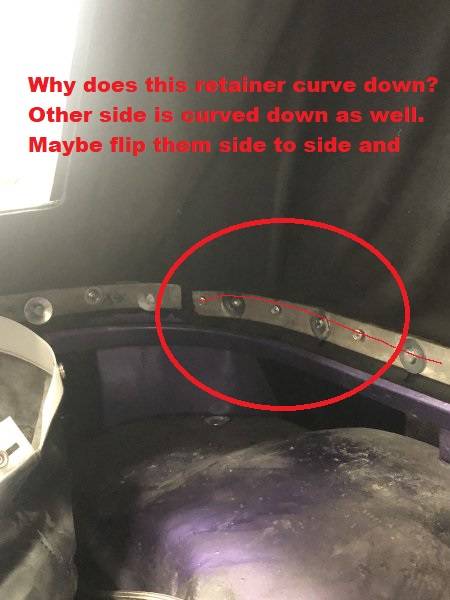

Noticed something in your pictures. I may be way off here but those retainer rails could be on the wrong sides. They both curve down towards the back.
Yep, I asked the shop the same thing. The owner said he would swap them, but charge me extra labor and he doesn’t think it will help???
