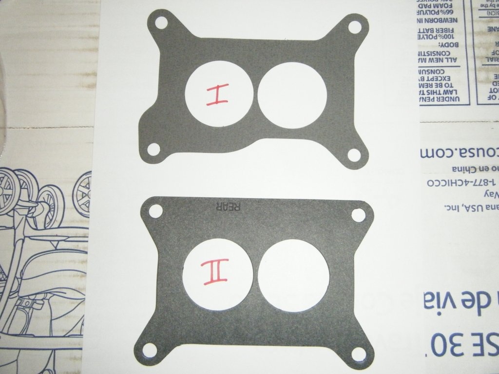

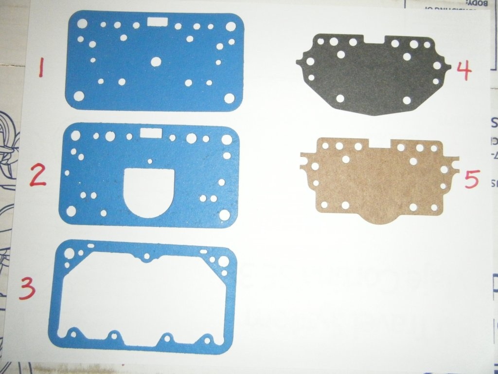

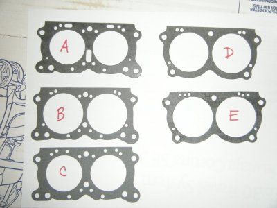

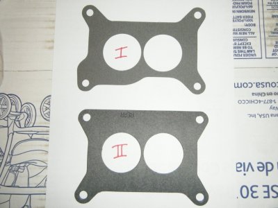

Can you help me identify these gaskets in my Holley 37-396 kits? I need some help just to be SURE I don't screw this up. Thanks Everyone!

I've now figured out that A & C are for 350cfm carbs (center) and B, D & E are for 500cfm carbs (outer) because the size of the barrel holes.

Agreed, a and d are the best ones to use for the base plates. 2 and 3 are for the center carb and 1,4 and 5 are for the outboard carbs.
4 and 5 go under the metering plate in the outboard carbs. i believe 5 is for 1969 style carbs and 4 is for 1970 and up.
