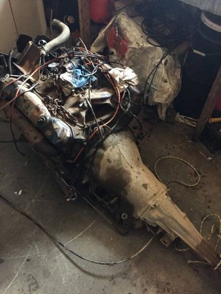

It may seem like a lot of money but deals can be had. Example: I just picked up a motor home 440 and trans for $300. Owner told me it was running when parked and the rv only had 42000 miles on it. It may or may not need a rebuild but even if it does, it can be done on the cheap and still make 400hp. I plan on getting it running in the engine test stand and flipping it to fund the Road Runner resto.
