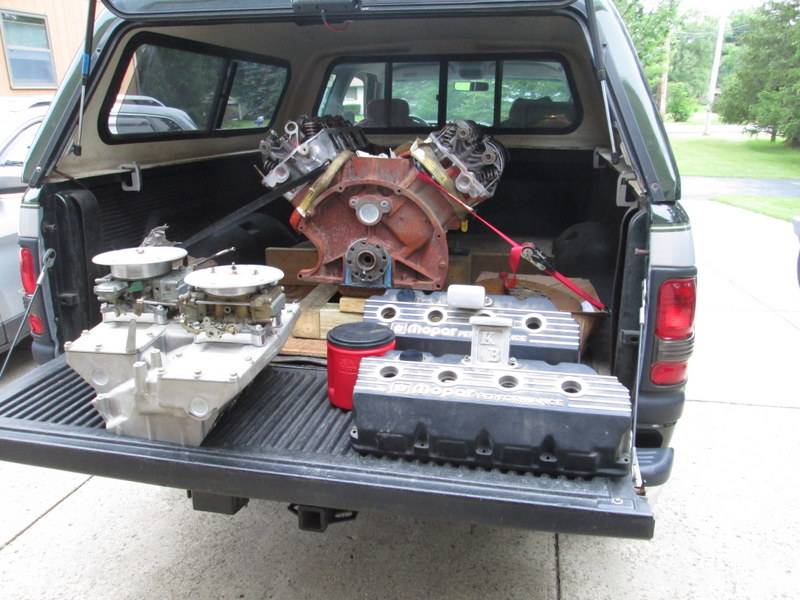

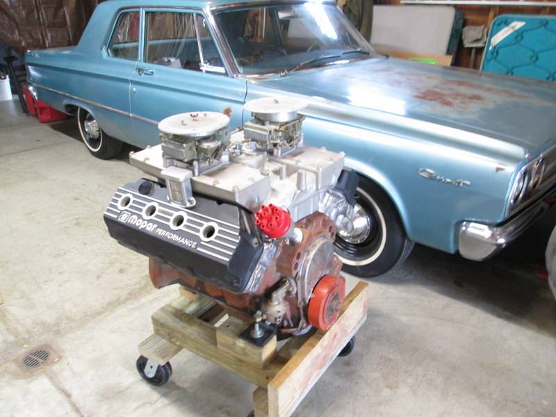

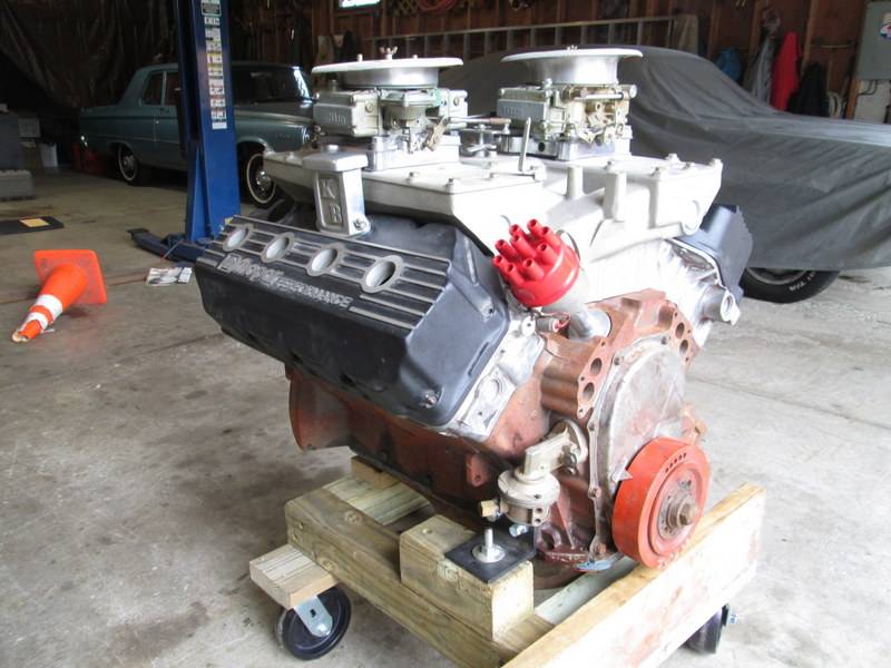

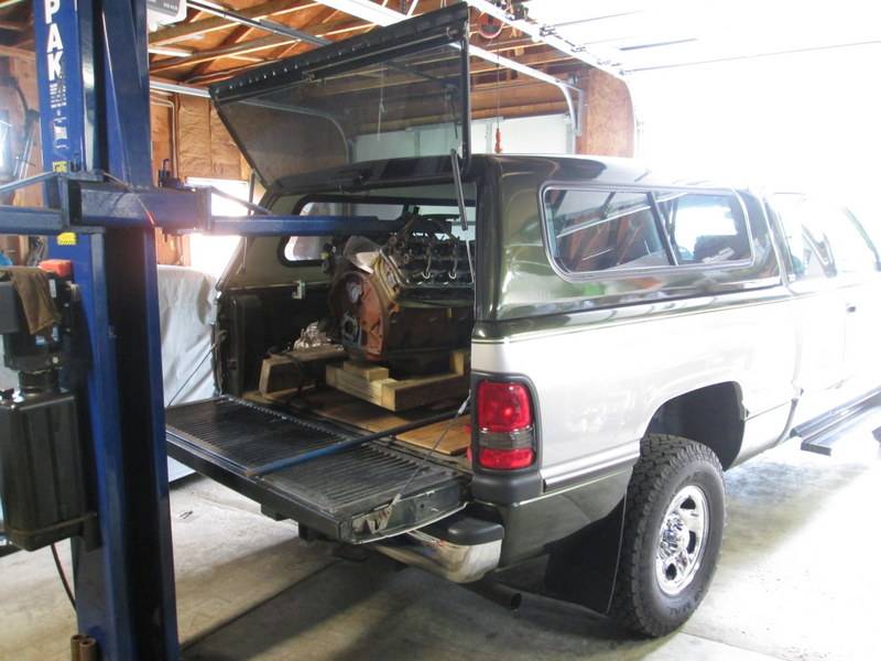

Well I decided to pull the trigger on this motor, and brought it home on Wednesday evening. It appears to be a new MP block that was never fired, bottom end assembled, only assembly lube present in the pan. Aluminum heads with what looks like minimal run time, possibly a break-in on another motor. Top end is as you see, MP X-Ram, with Holley 4235 & 4236 carbs, with air horns. Other odds & ends included. Plans are to dis-assemble, clean & check all parts, & re-assemble to use in my '65 Coronet, as a Street/Strip NSS ride. I will probably be selling off the top end intake, carbs, and valve covers, and going with a more Era correct set up, maybe just a dual 4, inline for easier tuning & upkeep. If you have any interest in the mentioned parts, drop me a PM, but it probably won't go for a while 'til I decide my path for sure. I want to THANK ALL who gave me some feedback when I posted for their input, and it's always appreciated. Thanks FBBO for this Forum to discuss...
Well I decided to pull the trigger on this motor, and brought it home on Wednesday evening. It appears to be a new MP block that was never fired, bottom end assembled, only assembly lube present in the pan. Aluminum heads with what looks like minimal run time, possibly a break-in on another motor. Top end is as you see, MP X-Ram, with Holley 4235 & 4236 carbs, with air horns. Other odds & ends included. Plans are to dis-assemble, clean & check all parts, & re-assemble to use in my '65 Coronet, as a Street/Strip NSS ride. I will probably be selling off the top end intake, carbs, and valve covers, and going with a more Era correct set up, maybe just a dual 4, inline for easier tuning & upkeep. If you have any interest in the mentioned parts, drop me a PM, but it probably won't go for a while 'til I decide my path for sure. I want to THANK ALL who gave me some feedback when I posted for their input, and it's always appreciated. Thanks FBBO for this Forum to discuss...View attachment 441051 View attachment 441052 View attachment 441053 View attachment 441054
