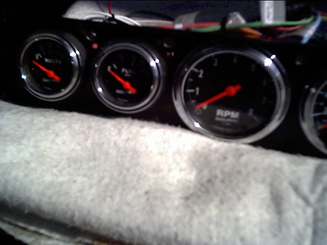

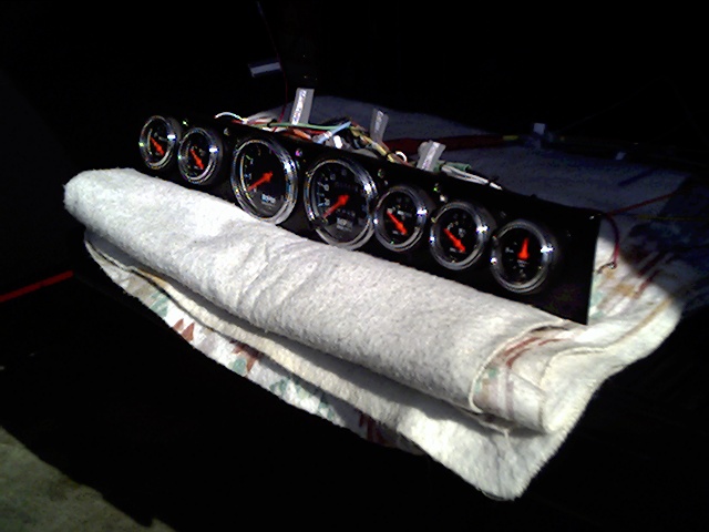

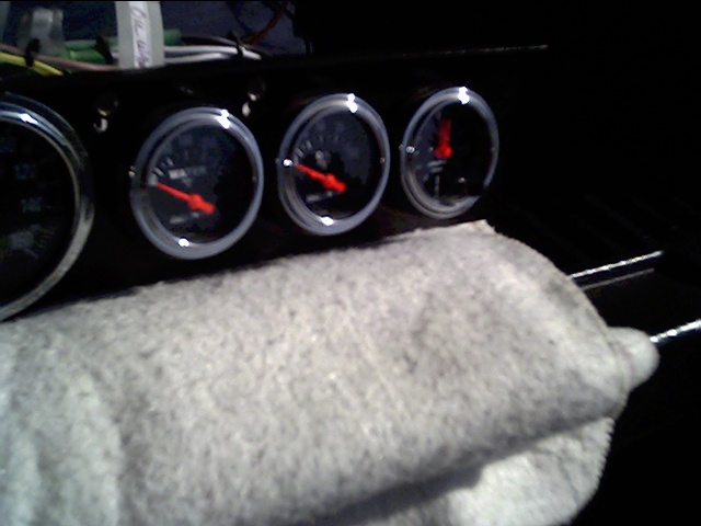

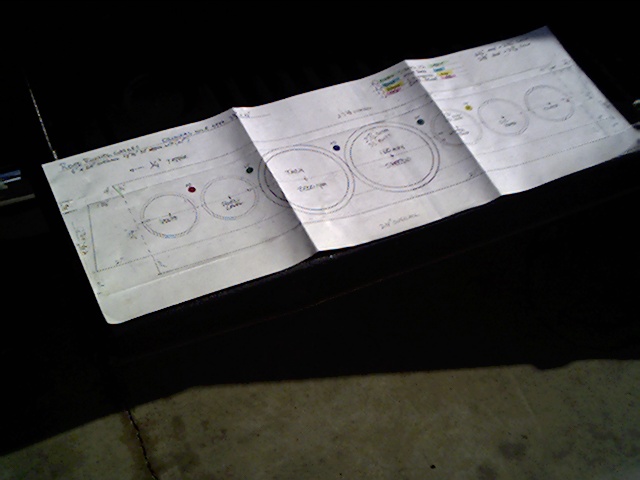

I'm not a very good photographer , Pattern & gauge panel for a 68-69 RR, GTX, Belevedere, Satellite etc. Self made with Autometer Traditional Chrome Analog gauges w/ black back grounds white numbers & red sweeps... Custom 7 gauge instrument panel for a 68 RR, 1) 3-3/8" 160mph mech. speedo, 1) 3-3/8" 8000rpm tach, 5) 2-1/16" gauges in angled pods to aim towards the driver, 1) Voltmeter, 1) Fuel Gauge, 1) Water Temp, 1) Oil pressure, 1) Clock & 5) 5/16" LED lights w/chrome bezels, , 2) green for rt./lft blinkers, 1) Blue for High Beam Lights in the center, 1) Red for E-brake warning light on the left 1) yellow for low oil pressue light on far rt. ... Just wanted to share... Any thoughts..

"Thanks guys" when I started to do the custom gauge panel, I never thought it would have got to the extreme that I did, my car has an original crappy inaccurate 68 RR 120mph gauge cluster with a factory tach, I will be removing it, I just wanted to have a decent looking panel with accurate gauge cluster that dosen't look like it's 43 years old, I don't know if I will sell the original cluster or not yet, I may keep it just in case I ever sell the car... I probably have $500 total in the new panel, not including my time of course...

I tried a few different ways of lay out, staggering the gauges diagonally & big 3-3/8" gauges to the far left or right & the some what centered, 3-3/8" speedo & tach. as you can tell that's the one I settled on...

Don't be sorry, No Offense taken at all, I'm so lame with a camera (& a computer) & I'm the 1st one to admit it, never really got into it... I think there are gauges with similar sizes, 3" would be ideal for the larger gauges but I couldn't find any, that I liked anyway... The opening were the Autometer 3-3/8" speedo & tach. gauges is the biggest problem, part of the chrome bezel will be covered by the lower dash pad (with out altering the lower dash pad which I'm not willing to do), the pad should only cover the very bottom of the bezel on the 2 large gauges (the opening is 3-1/8"or so at that point so about a 1/4" will be covered), I think it should look OK, when I mock it up again finally I will show how it fits & looks... There are some gauges with white back grounds, I'm not sure they make them in 3" - 3-3/8" range for speedo & tach., I liked the period look of the Black Autometer Traditional Chrome bezeled gauges... I need to check to see if they are available in the proper sizes with white backgrounds, it dosen't have to be 7 gauges, I just wanted all of those gauges & clock, it could be 6, 5, 4, & still look good & fit easier, I think... VDO make some nice vintage looking gauges, with white back grounds, when I finally get around to installing it, if it works out like I think it will, I may be willing to make a few of them for other people for a slight profit... The biggest problem is the cost it would be hard to make much & be able to sell them, I've got probably 8hrs labor & at least $500 for the gauges, pods, LED lights, different colored wires, shrink tube & connectors etc. in it... I'm sure if I had a resale # to buy in bulk at cost, I could get a better price on parts, but the time to build the harness & fabrication would probably kill any profit... I'm sure if I did several of them at a time, I could kind of mas produce the harness & plates a little quicker I'm sure....

:iamwithstupid: Yea a professional photographer or a 10 year old with a cell phone camera can do a better job taking pitchers than me, I think...LOL... I noticed you can't even see the angled pods that the 2-1/16" gauges are mounted in to redirect them towards the drivers view... Poor job with the camera... Oh well...
Try again with some new photos
Try again with some photos on a different setting & white background... Well it's a little better, I don't see a future in photography for me anytime soon...
