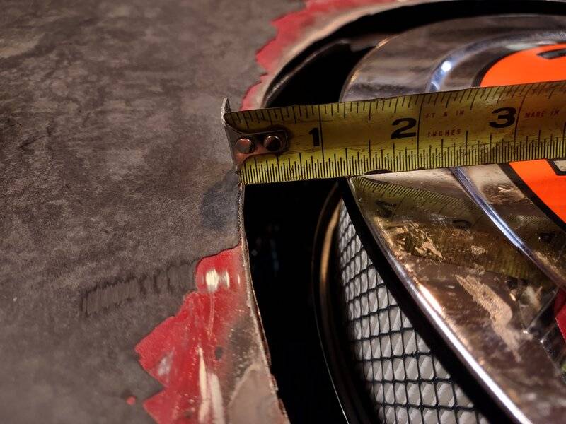

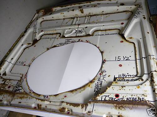

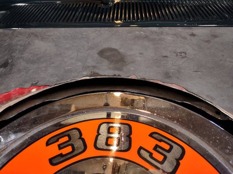

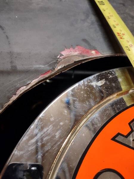

saw this on the web sometime ago and I put it into my car files. Hope it helps

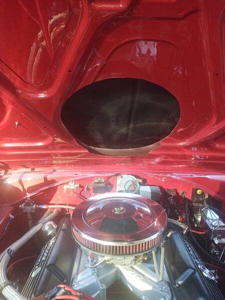

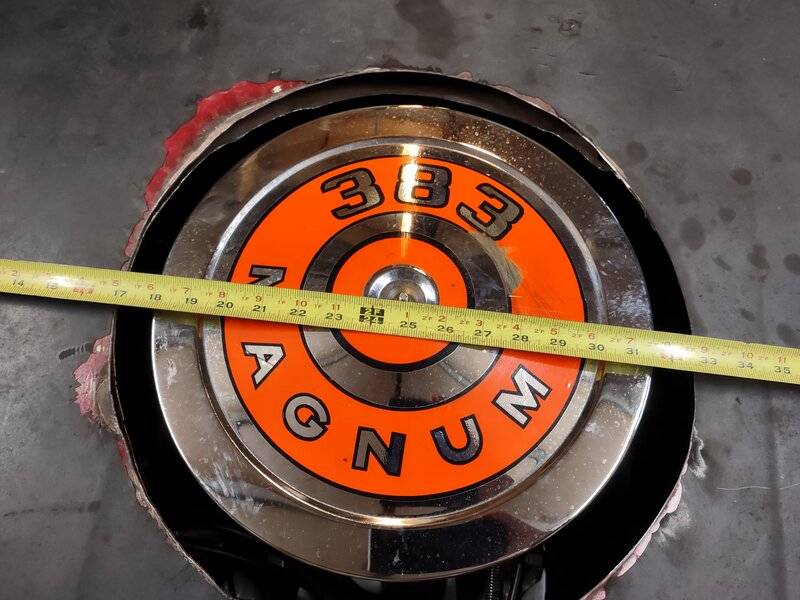

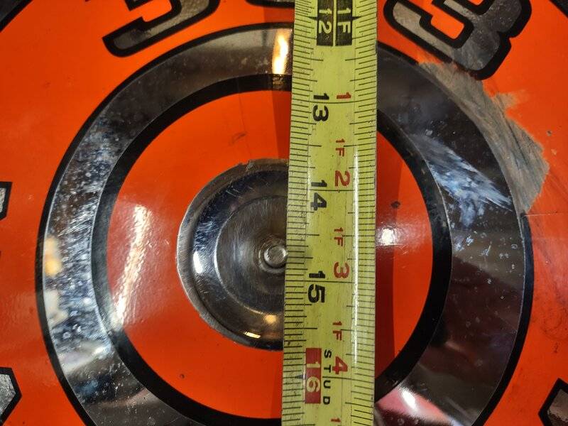

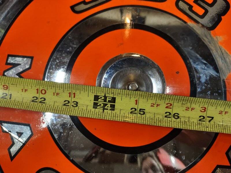

With around a 16" hole we did cut into the rear box and the pass side stiffener. I'll probably put some seam sealer on the narrow gap and fit in a piece on the rear gap to box it in.
Don
Thank you for the photos
they were a big help

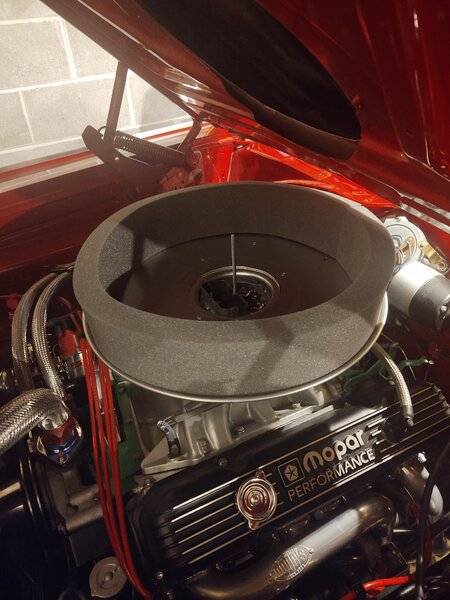

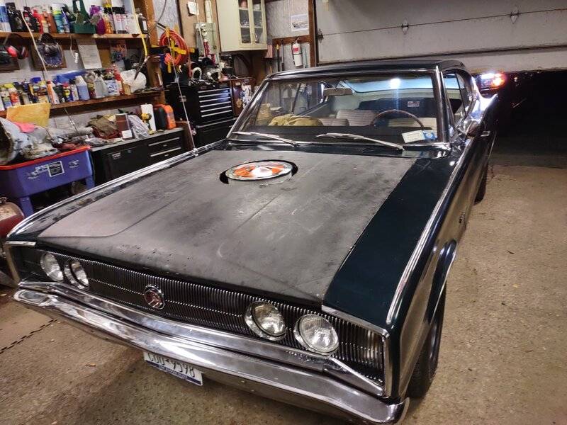

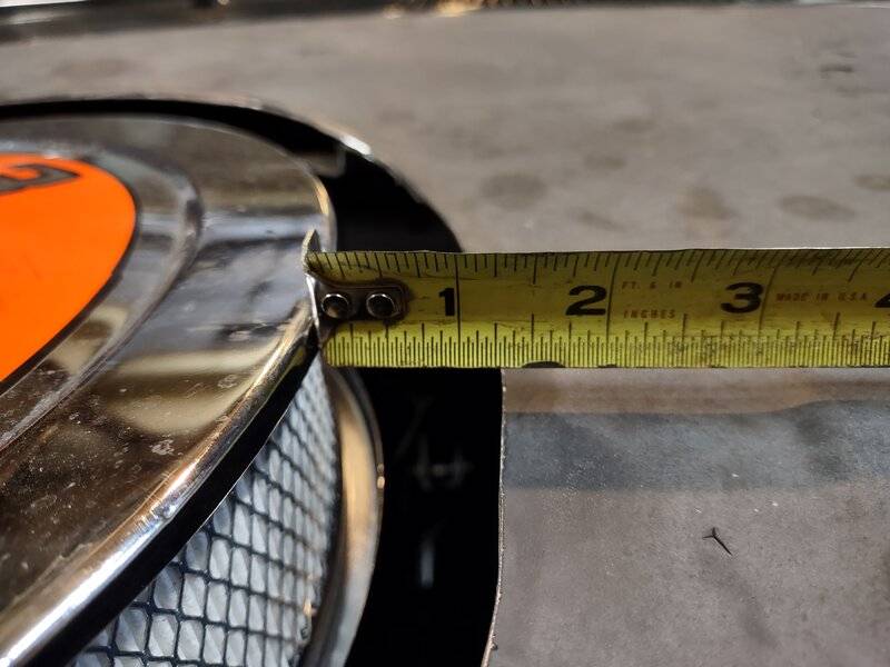

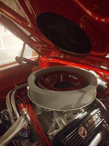

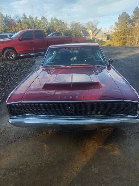

The car is home
We ended up doing it like Don Frelier
a 16 inch hole clears the 14 inch air cleaner
also am adding a 1" spacer and a 3" tall filter
I have yet to build an air pan but it will be coming along soon
