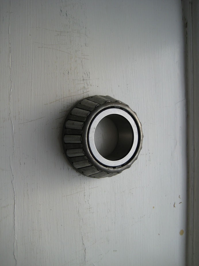

Need a race to my bearing, Dana 60 big pinion bearing, Timken HM 803146 at the bearing.
Thanks Sven

That should be Timken HM803110. for the front pinion. Sure you wont need both, to change as a set???
Did you need the number to source in Sweden? or need one shipped from here? I could do it, unless someone else has a closer inventory on hand on site.

Hi! Must be the back pinion, the front is smaller number at front bearing HM 88542 and race 88510I so I guess that's correct number for the big bearing race HM 803110, asked here in sweden, yes we have them races 3 different sizes and I can't see the sizes, you have to order all 3 complete bearings and we don't take returns, I just thought if someone has one or I have to order from doctordiff or someone else, I have a Ratech Deluxe Ring and Pinion Installation Kit Dana 60 3017K complete kit - the race, outerdiameter should be close to 3.5", there should be no problem only buying the race, thank you very much red.

To add further clarification the race number is the match for the bearing you gave, which my 1985 Timken catalog calls the 'head'. The 'tail' is bearing HM88542 and cup HM88510. side bearing are 387A / 382S for 9 3/4 ringgear.
These usually are sold 'each' here by the bearing houses i have worked with.

Great info, now I know the correct number is HM803110, and all other numbers are also correct, I wait if it shows up here or I have to order it somewhere else, why couldn't that idiot in Sweden find that number, it really doesn't matter because for disc brakes bearing cost in USA $30 for all 4 and seals are included here they want $190 for just those 4 bearings, thanks again red.
