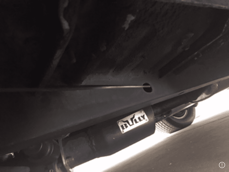

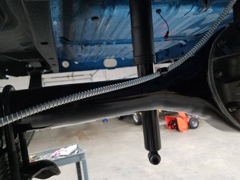

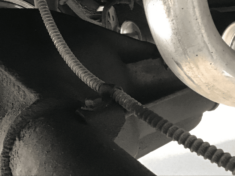

8 3/4 rear ends have this welded clamp on the right side of the axle to secure the e- brake cable. Was under my Bee that has a Strange 60 and noticed that that clamp is missing and the cable has wore some paint off the frame from not being secured in this area. Did original Dana's have this clamp as well?

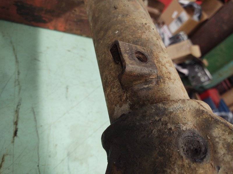

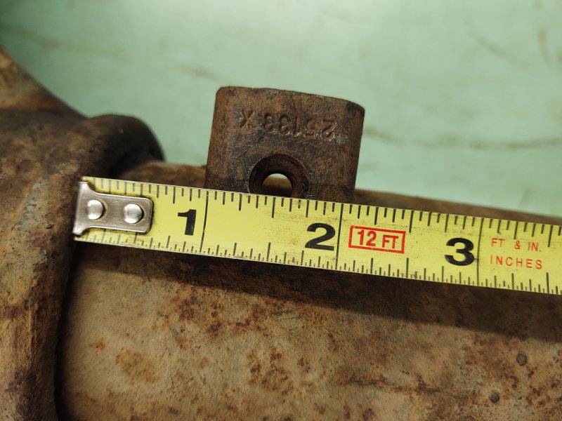

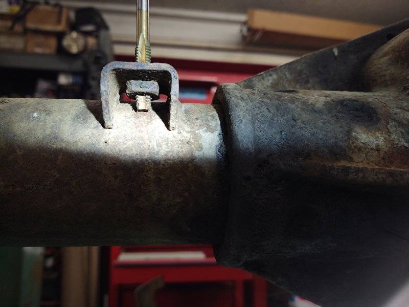

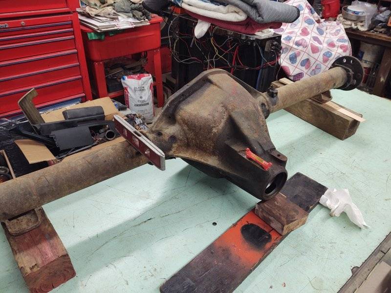

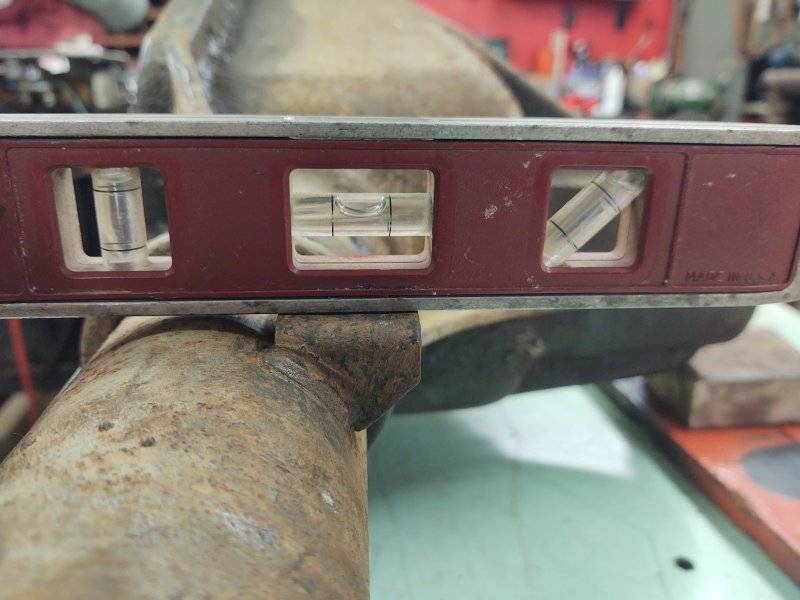

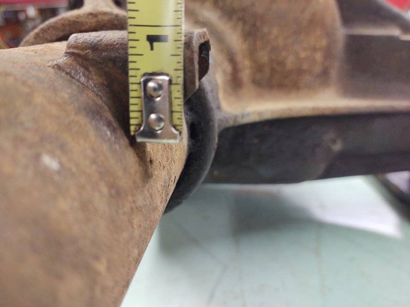

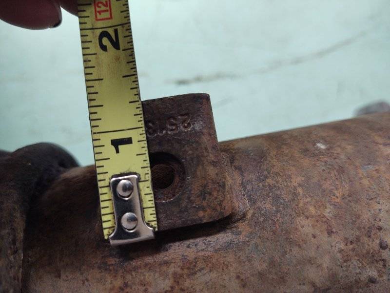

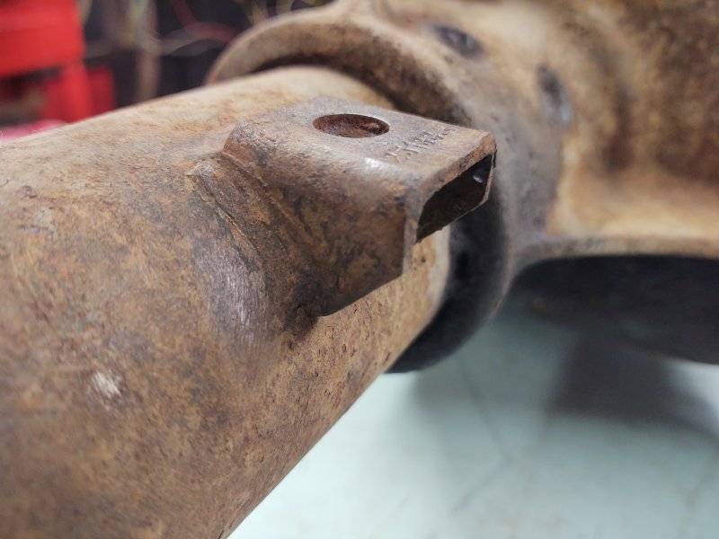

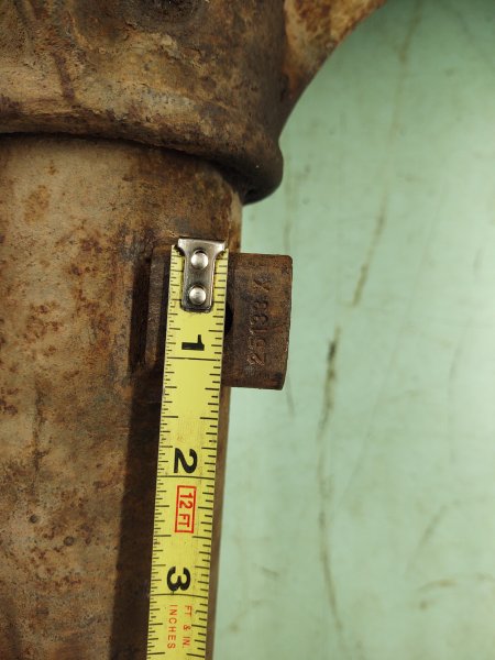

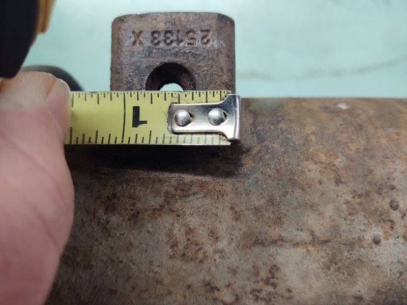

1967 factory Dana has a welded bracket that a bolt threads into, right where the tailpipe can rub it.
Same bracket on the 69 as the 67.... Staying warm on the West side?
