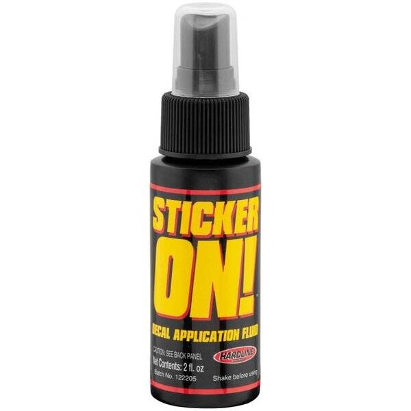

I know people will just say soap water, but I swear by this stuff.
https://www.hardlineproducts.com/product/sticker-on-decal-application-fluid/

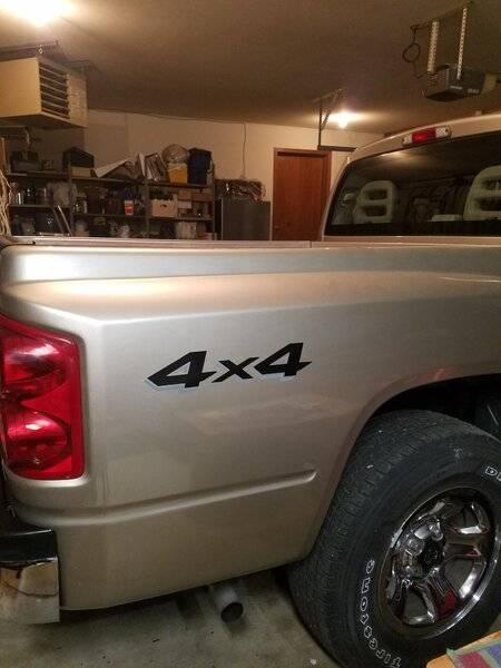

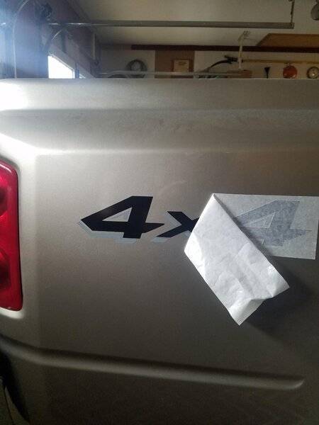

Greatly appreciated your tips. Install went pretty well. The decals were cheap; but my big concern was if it didn't work out so much, I'd have the hassle removing it to redo. (I did that on the replacement box prepping it for paint. The body shop had me using...a rubber wheel power tool and heat gun.) Not thrilled about maybe having to take it off the new paint job risking marring the paint. Anyway hung the decal off masking tape and called a buddy over thinking I could use two more index fingers to hold the edges away from the body while I went down the center of it with mine. Then used a foam pad working the decal out to the edges and more finger grease to press the decal. There are a couple pinhead size bubbles that I'd a thought couldn't be there with all the working it to the body to flatten it out; but all in all can't tell unless looking real close.
