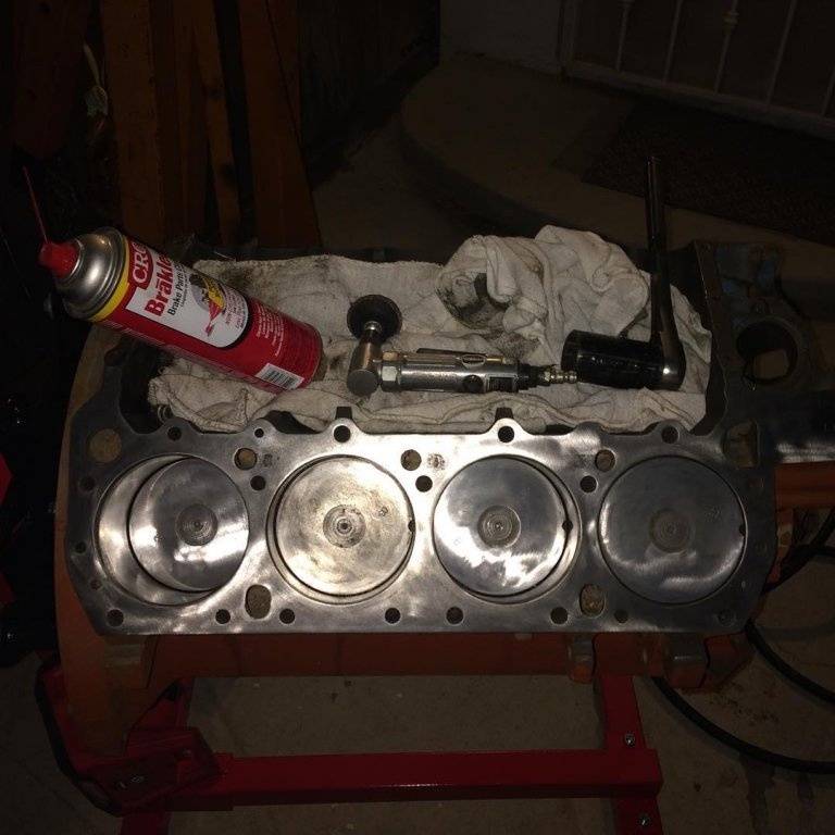

That being said there is still copper coat on the deck surface, whats the best way to clean it?

Wish I could remember what they're called but I use the scrotchbrite looking disc on a 90 degree die grinder... I'll try to find a picture. One thing I like to do before bolting anything on is confirm that all oil passages are clear. I spray a parts cleaner threw the passages to be certain that I can see it exit. This is the best time to check the passage from the cam bearings to the rockers before cam install.

Is the block still bare? I'd use a scotchbrite pad, wet with kerosene, to clean the head surface.

Never use a wiz wheel on your deck. Laquer thinner, razor blade, and red scotch brite pad (use by hand) is all you need.
If your not comfortable using a whiz wheel with the scotch brite disc then use the green rubber ones. They work good on sealing surfaces without causing damage. The scotch brite ones are good but aggressive, if you're not careful you could create a low spot ( although we are talking about iron not aluminum, I use the scotch brite all day with no problems ) ....
This!
Roto locs will remove material (metal). Also the copper coat will clog it up right away.
The lacquer thinner will remove the copper coat just by itself, useing a rag.

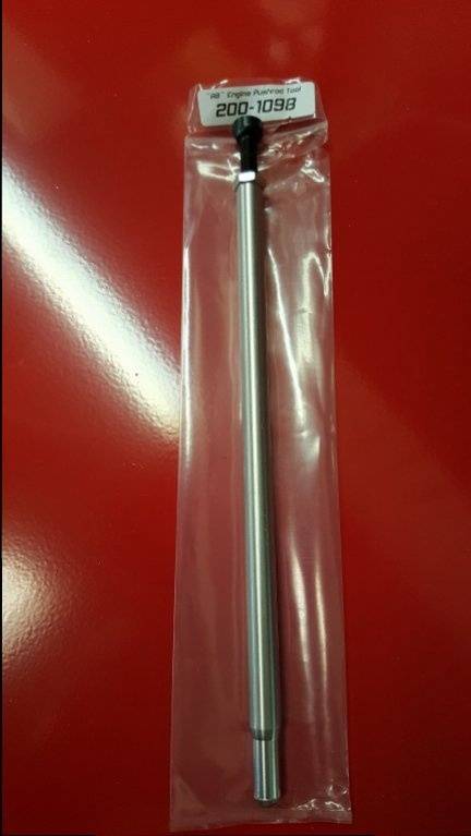

Pushrod checking tool from 440 Source. I even used it to watch the valve cycle with double springs. 200-1098
You might want to at least install one head and rocker arm to check the estimated lenth that you will be useing, just to make sure the range of the pushrod checking tool is what you need. They make different lengths.

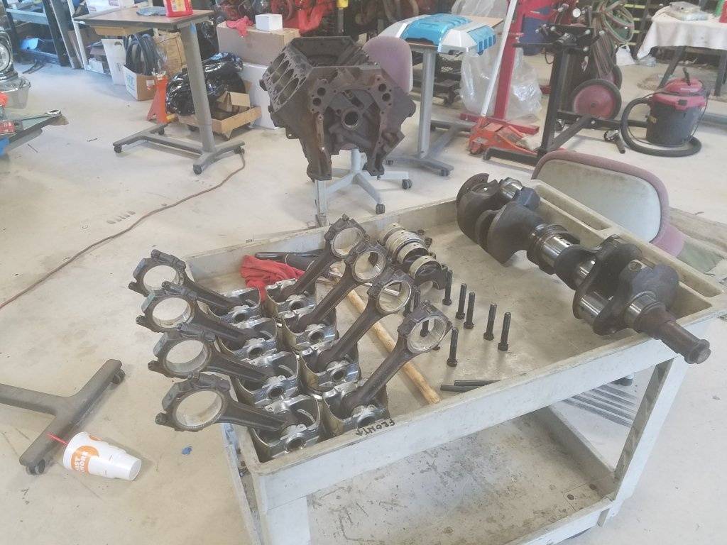

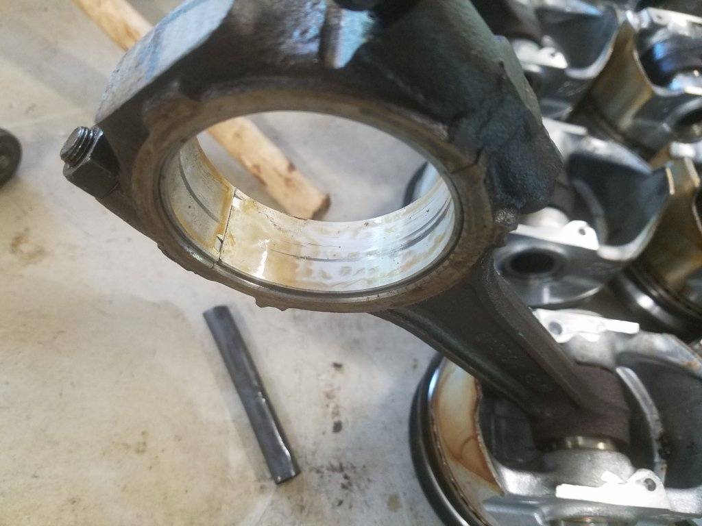

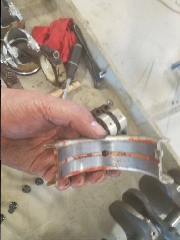

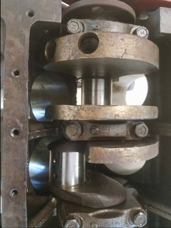

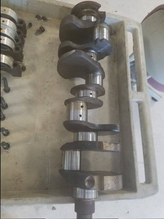

Well I tore it down today to ship off to the machine shop... was pretty pleased with what i found. The crank was perfect, bearings are all new. Will probably need to replace though. A couple had some scratches that you could feel on a couple of them...I'm guessing from some trash.
Was also able to confirm that the pistons are the KB-236...
