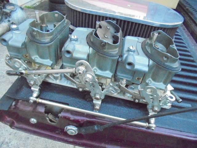

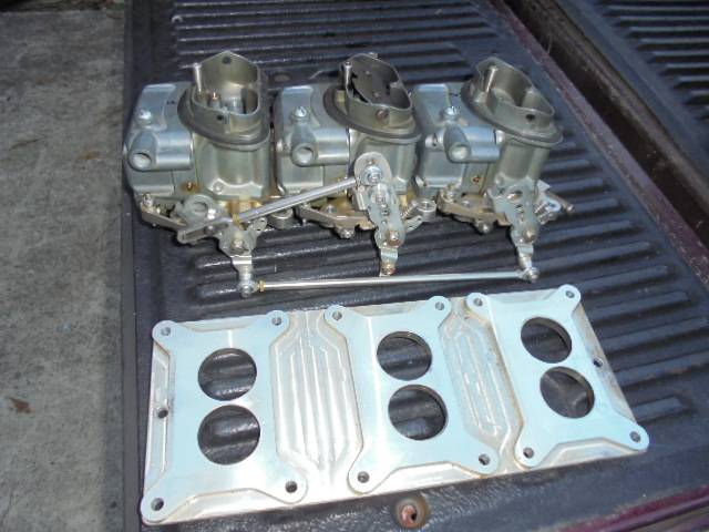

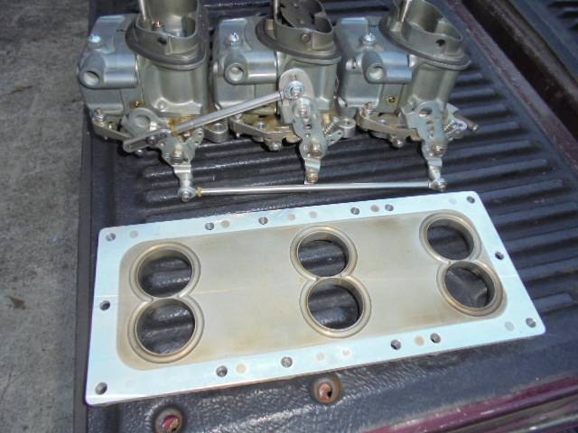

will the demon carbs fit on an edelbrock 6 pak intake?reason i ask is i got the set up minus the intake but it came with an adapter plate.i tried google but can't find out anything about the adapter plate.any info is much appreciated,kent
i think you are correct 65RR,thanks.so,can i mount these on an edelbrock?
Just eyeballing the pictures, it looks like they'll fit a stock Edelbrock intake.
that's what i was thinking but don't have an intake to verify.thanks for your input,kent

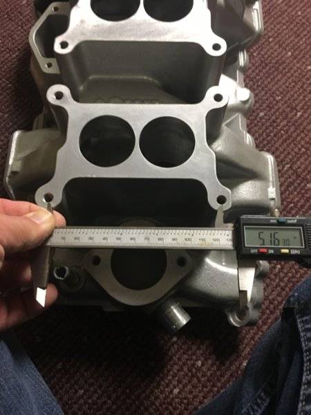

I only know if three bolt patterns for six pack carbs. There's the three and four bolt that were on the Poly, and then the larger four bolt that was on the Edelbrock six-pack intake, which looks like this one.
anyone have an intake that they could use to measure the hole pattern for me?thanks
I do! It’s midnight plus here and I’m at work. I’ll get ya tomorrow late morning.

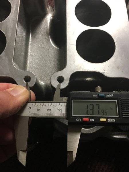

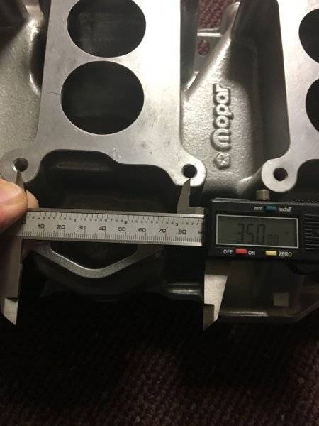

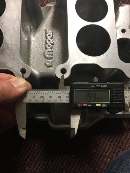

I think this will help.
All measurements are roughly eye balled center to center where the carb stud goes.
Middle carb, front to rear bolt spacing.
(all the same otherwise)
Distance from the rear of the front carb to the front of the center carb.
Rear Center to rear carb front
Front carb side to side
that's what i needed,thanks.all the measurements match and i'll assume an edelbrock is the same as a M.P.thank you for taking the time to do that.much appreciated,kent
No problem Kent.
Yes, the Edelbrock and the MoPar intake are identical since Edelbrock has always made the intake for Chrysler’s 340.
